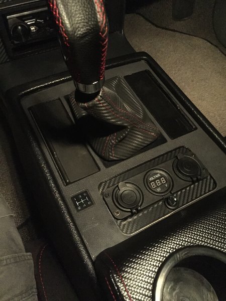

    The fiero was offered with power windows, but is was not a common option to have, so with my manual windows, I have a blank space in the center console begging for some electronics. I tossed in a bolt meter, 12v socket, and low voltage usb plug. I wired it up from the factory 12v socket that was getting covered up. the factory 12v was a constant on, so to keep from draining the battery, I added an inline switch.
    being an 80s car, there was also a severe lack of cupholders. going from 15 in the Tacoma to zero in the Fiero has been a tough #firstworldproblem to deal with. I really liked the shifter boot that Blacktop Racing made for me, so I went back to them for a center console upgrade. they made me a matching armrest/cupholder that bolts down to the center console. not only does it solve the cupholder issue, but it puts your arm in a much better position for shifting. the fit and finish is also beautifully done.
    plain center console with the new 12v slices.
    new armrest/cupholder installed.
    shift boot and armrest together. the interior is really coming together.
    new mount for a truly hands free experience

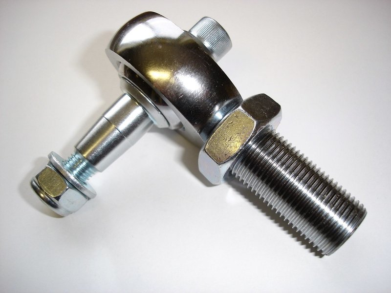

    Interesting councidence. I have been seaching hopelessly online for an adjustable set of sway bar end-links. Since I am converting to XR sways. Your idea, might just do the trick.

    For the swawbar, message me when you get close to Doug the work. There is some extra work needed to convert a Tacoma to use this type of end-link.

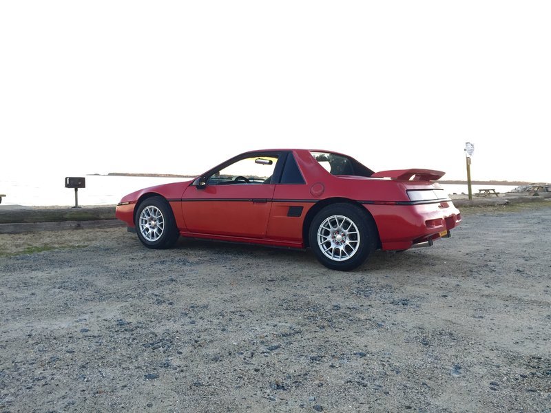

    Ooh, I completely forgot the whole car photo from last Sunday. For the maiden voyage, I tossed the wife and dogs in the passenger seat and we rolled down to the beach.

    Will do. Here's the catch. One end needs to be a joint, while the other is straight.
    What we're her thoughts on its new ride quality?

    The jointed end isn't a problem. A rod end with a taper bolt (if needed) makes for an easily adjustable end with the bushings on the other end. If the rod end has male threading as pictured, I can make you the tube adapter that it will thread into
    Torspd[QUOTED] likes this.

    And Alexis really had nothing to compare the ride to, but it's smoother than her Honda Fit, while also handling far better. Best of both worlds.

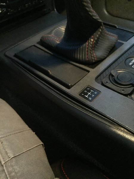

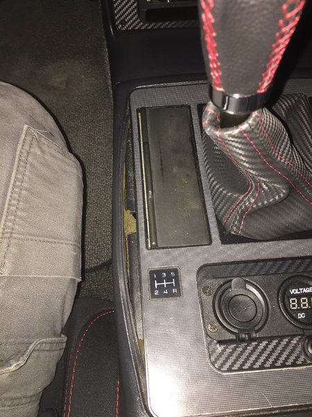

    the fun of an old car. most of the interior dash and center console is made of a very dense foam-backed rubber. its a great material that doesn't scratch like the hard ABS plastic on modern dashes, is easy to clean, and in general, just holds up well. however, in high traffic areas, like where your leg constantly rubs against it, it can wear down, and pull away from it's mating surface.
    luckily there is a solution. for the center console, there's a specialty hard plastic cover that essentially glues over the old misshapen piece.
    first two pictures are of the worn out piece. second two pictures are of the cover glued on.
    no more gap or unsightly foam sticking out. all shiny and clean.
    all that's left now is the ash trays and doors need a little revamp, and the interior will be good as new. thinking about turning the drivers side ash tray into a hidden switch panel, and just reworking the passenger one into a little storage compartment.

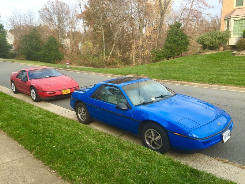

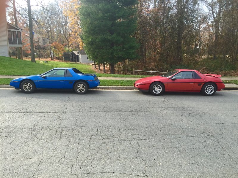

    My uncle, who's given me so much help over the phone throughout this whole build, drove his fiero up for the holiday. It's a very surreal experience finally getting to cruise around town with him. Love them or hate them, it's certainly a head turner when two drive by.
    Happy thanksgiving everyone!

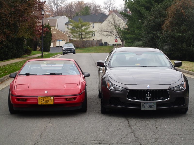

    The 1988 and 2014 versions of the "poor mans Ferrari"
