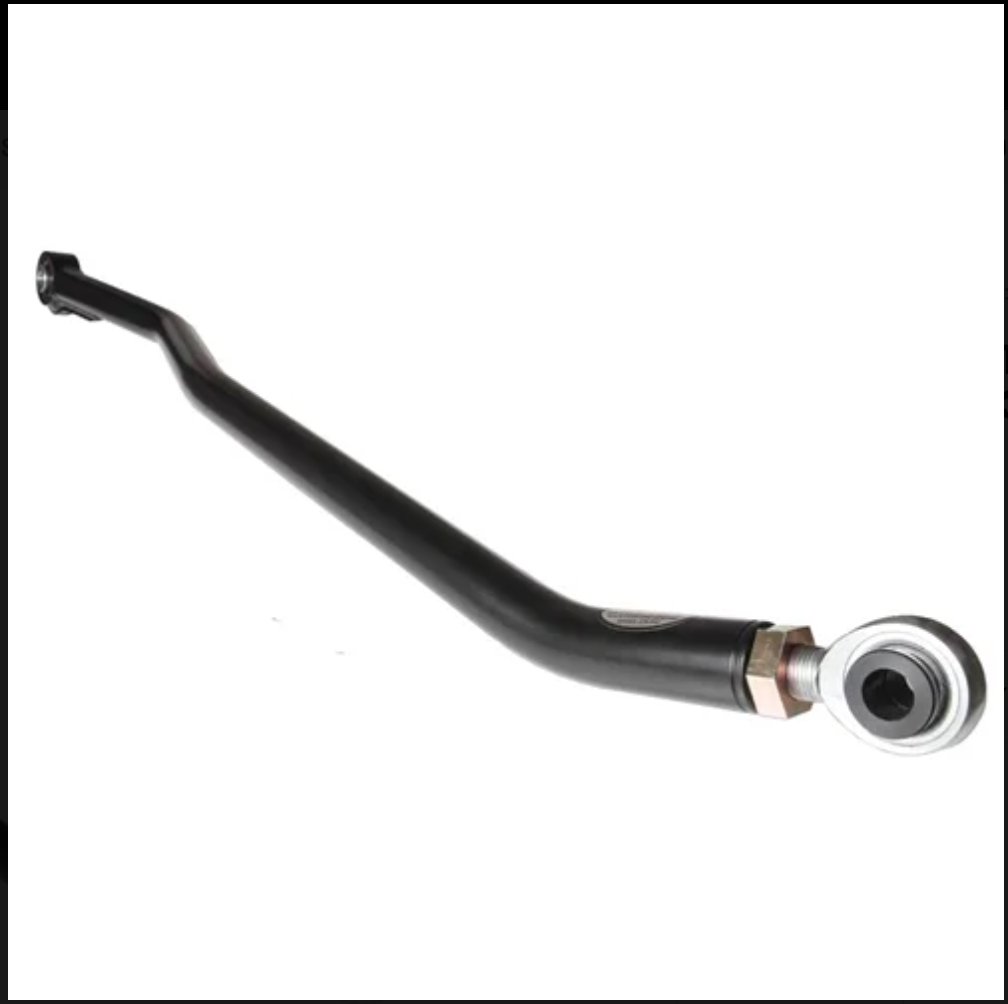

    -Since you purchased the popular 2013...death wobble. Keep the track bar in good health. If you ever experienced death wobble in a solid front axle you know what I am talking about. Now amplify it by a lot with a big ass truck. If it hasn't been done already, a good quality aftermarket track bar is well worth it (with replaceable joints). This will run 325-500.00, so start saving now. In addition you might wanna look into a steering box brace as well. These are ~140.00 and really stiffen up the steering.

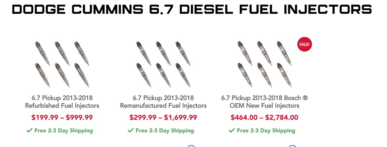

    -Injector fund. Start one tomorrow. Here are three different set of injectors. From left to right...shit, polished turd, gold. Places like Pensacola Diesel are tempting when you see the price, but I am telling you this is an area that you don't want to cheap out. Motor replacements are not cheap. I haven't checked the cost of a 6.7L short/long block lately...but it was around 5600.00 just for the motor and 22 hours shop labor. You will need new transfer tubes and o-rings as well. To replace the injector is pretty straight forward if you follow a procedure and do one at a time (your first time).

    Death wobble will just happen once the track bar wears. Usually when crossing train tracks or something that shakes the front end. It happened on my 2002 and thought my front end was coming out from underneath it. If you’re lucky, it might have been updated already.

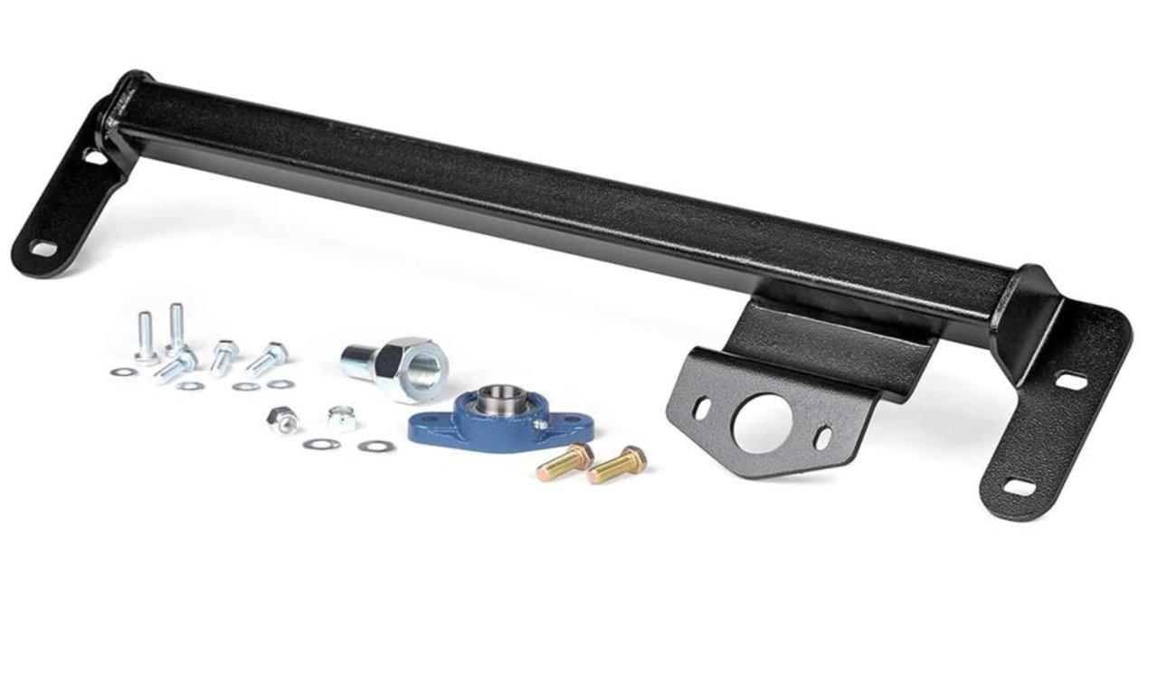

    Steering…if it feels decent now, I would just splurge on the box brace for 140.00 after you pose in one of those firefighter Calendars and get PAID!!!

    Link to that Steering box brace?

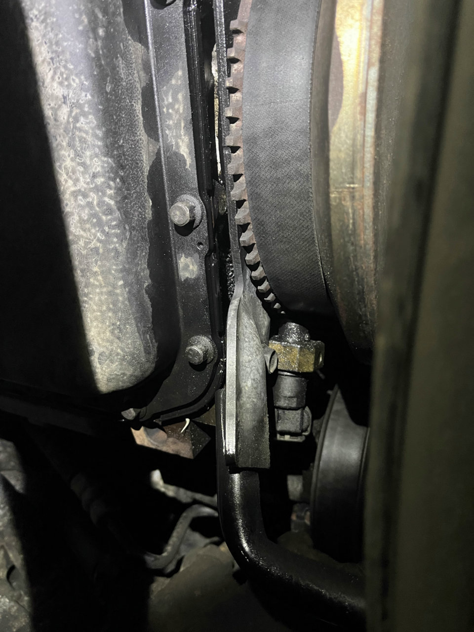

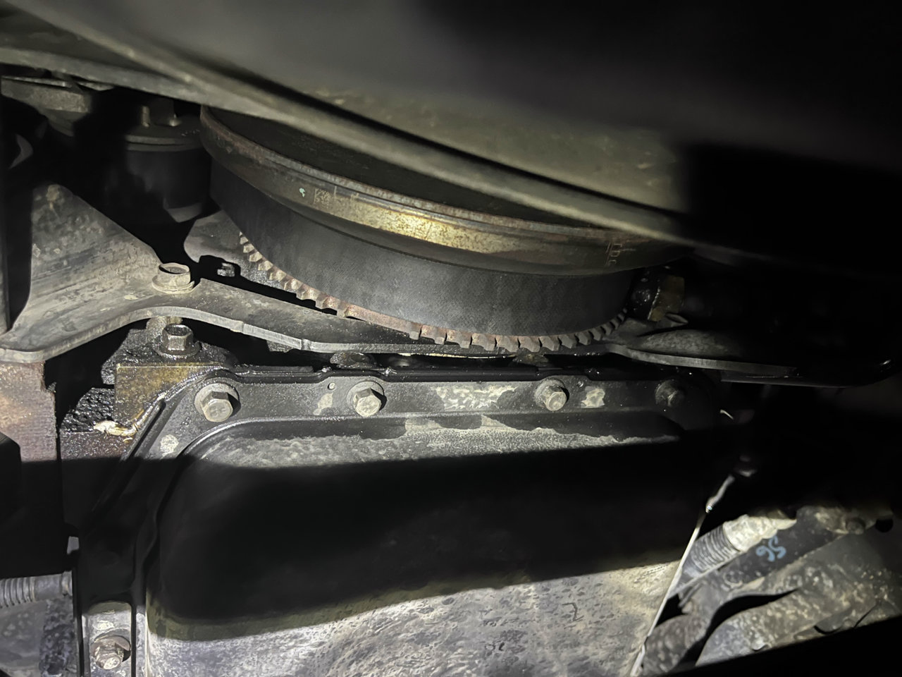

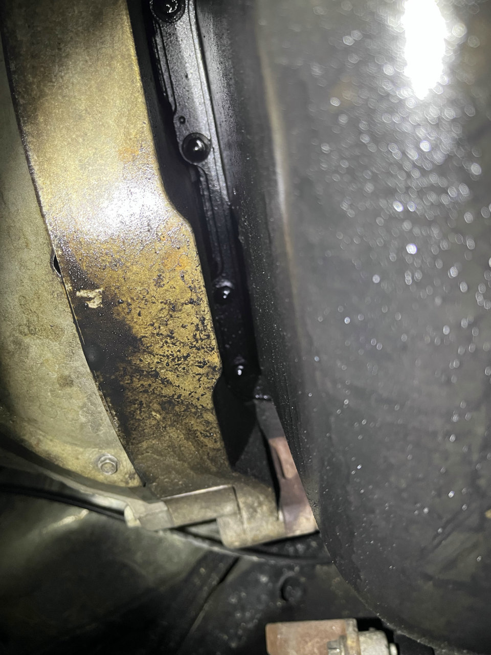

    also crawled under the truck and i discover the first (hopefully not many) oil leak. Looks to be the oil pan gasket. Just on the Front and at the rear, Photos below. Gonna take it by my local mechanic who's done great work to look over it with professional eyes so i can build a gameplan before dumping money into it on frivolous things.

    Google Ram 2500 steering box brace. You have tons of options.
    Sometimes the bolts back out a little on the oil pan. I would re-torque and see if that fixes the problem. Replacing the oil pan gasket is a PITA due to the cross member. You can Jack up the motor a little, drop the pan down, fish the new gasket under the pick up tube and back out. It really doesn’t look that bad to be honest. Just make sure it isn’t coming from someplace else.

    Yeah ive been on the CJC offroad website and theyve got one from synergy for 200$ shipped i think.
    Yeah the front bolts were loose so i tightned them down. Didnt get a chance to do the rears, but it didnt leak for 2 days so hopefully it's just the bolts being loose, i didnt torque a spec, just till they were tight. Yeah it doesnt drip on the ground so im not super concerned, but i hate leaks lol. Tomorrow i'll have a full list of things she needs.
    All the fluids beside the power steering (which was low) look fresh and clean.

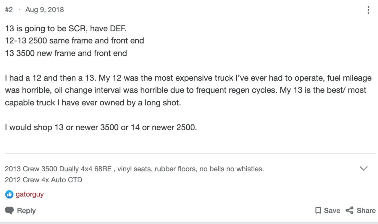

    2013 is the transition year. That's why it might be difficult to get a "part" number. In 2013 the 1 ton trucks changed interior/frame/axle and suspension. 2014 was the first year in the 2500 that went to coil rear and new radius arm front suspension like the 1 ton. I remember a buy back or something due to rear axle failures on 10-12 3/4 tons. I have been out of the Dodge/Ram scene for a while, so my knowledge is not up to par with others.
    Going back to a 2002 24V truck is getting pretty old. I have seen some really low mileage ones, but I still would stick with a CR truck.

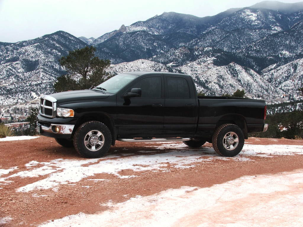

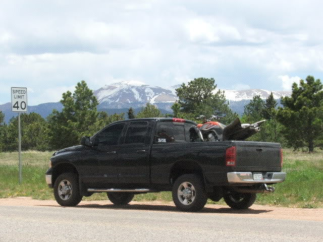

    Oh I don't have the 2002 HO truck anymore. That went buh-bye. I sold it just under 200K miles. It had a hard life.
    This was my 2004.5 CR truck.
    Stock
    Not even close to stock. I had 295's on it and really liked them.

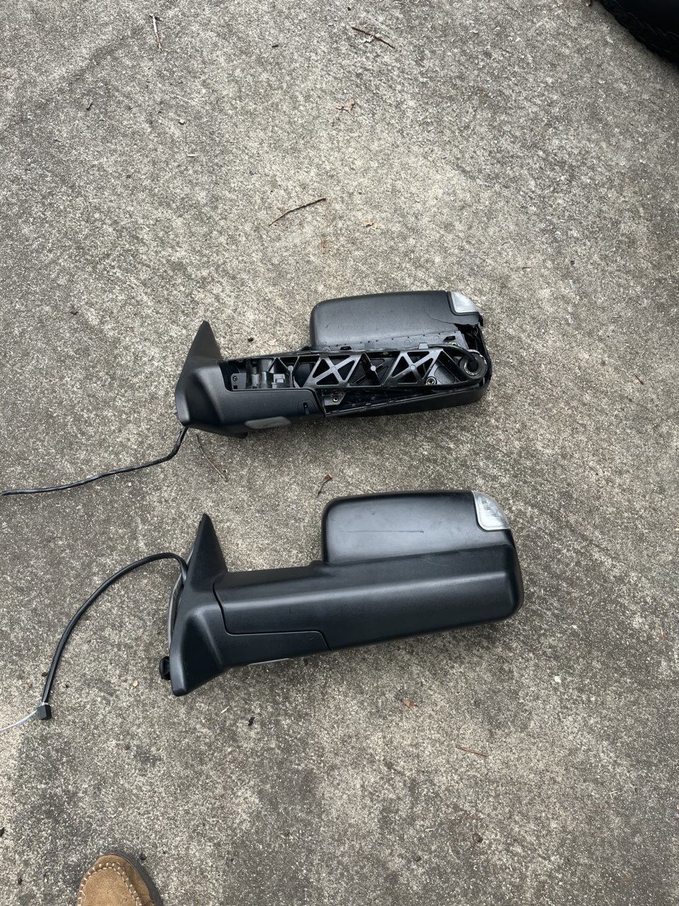

    also got the black eye of the truck taken care of. old mirror replaced with the new.

    Get em' I actually got reminded to silicone the Puddle lights on the new one. Mopar dont do weatherproofing i've learned so far lol. The Third Brake light leaked on the previous owner.

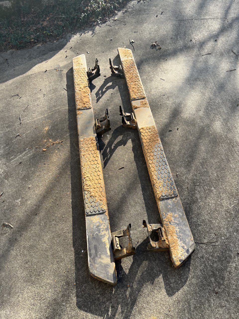

    Also swapped out the Chrome steps for some Bronze ones. The guy i bought em from was an older gentleman who basically lost everything when his camper exploded with him in it. He was covered in burn and bandages. The color wasnt my first choice but the price and the story behind them sold me on them.
    They compliment the earth tones of the truck thus far.
