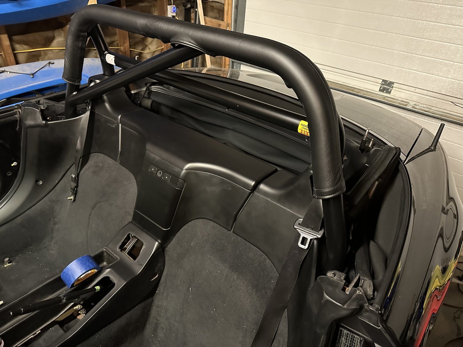

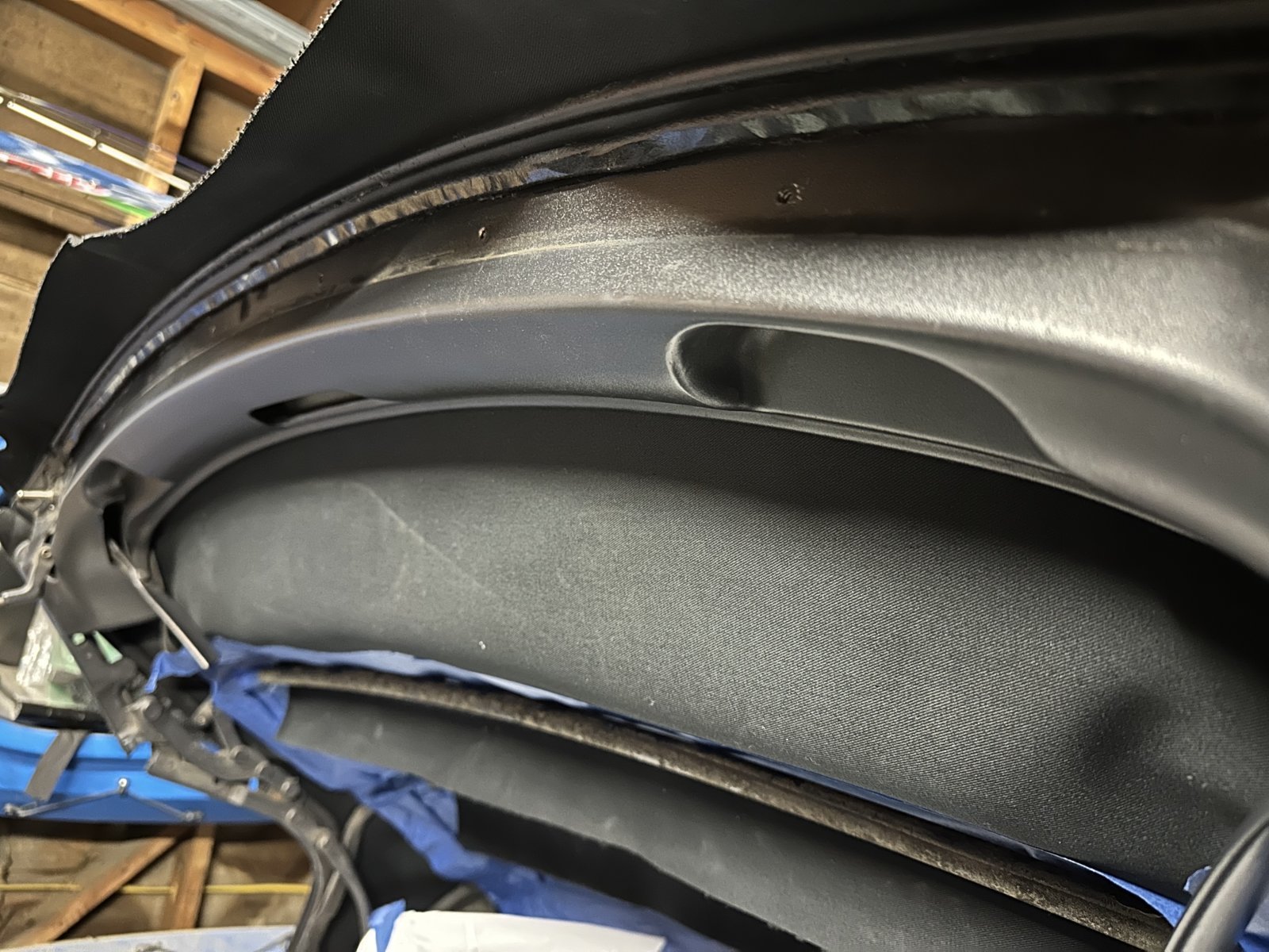

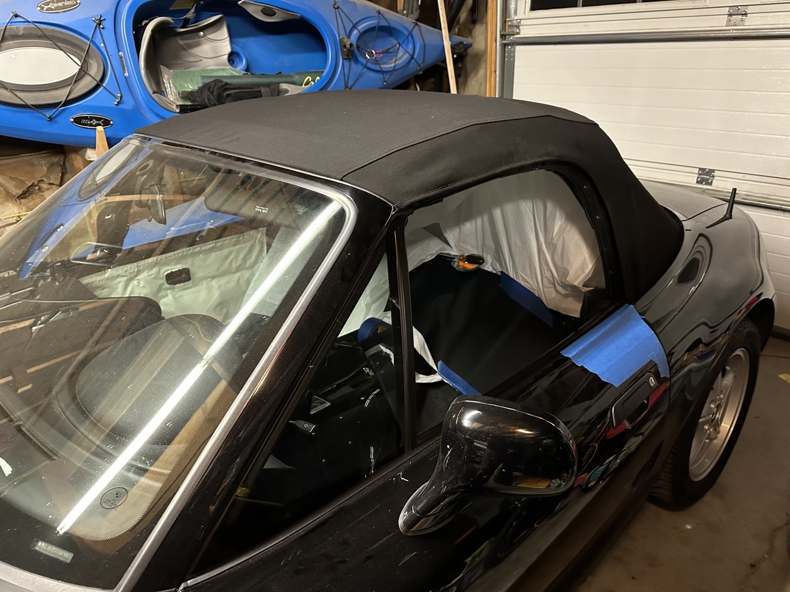

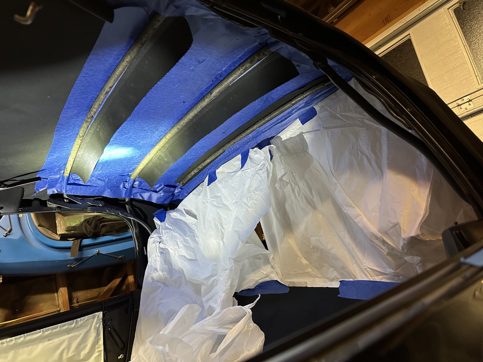

    After the kids went to bed I ran a fresh strip of butyl up front and reinstalled the last 10 screws.
    Then I protected the canvas headliner with painters tape so I could get wild with the spray adhesive.
    Pretty happy with the finished results. I may have to pull the front a little tighter but I'm going to wait and see. Next up I need to install the roll bar and then I'll reinstall the stereo, seats, door cards, and steering wheel if I can figure out the wiring for the new wheel...I have parts coming but need to order a sacrificial wiring harness if I can find one.

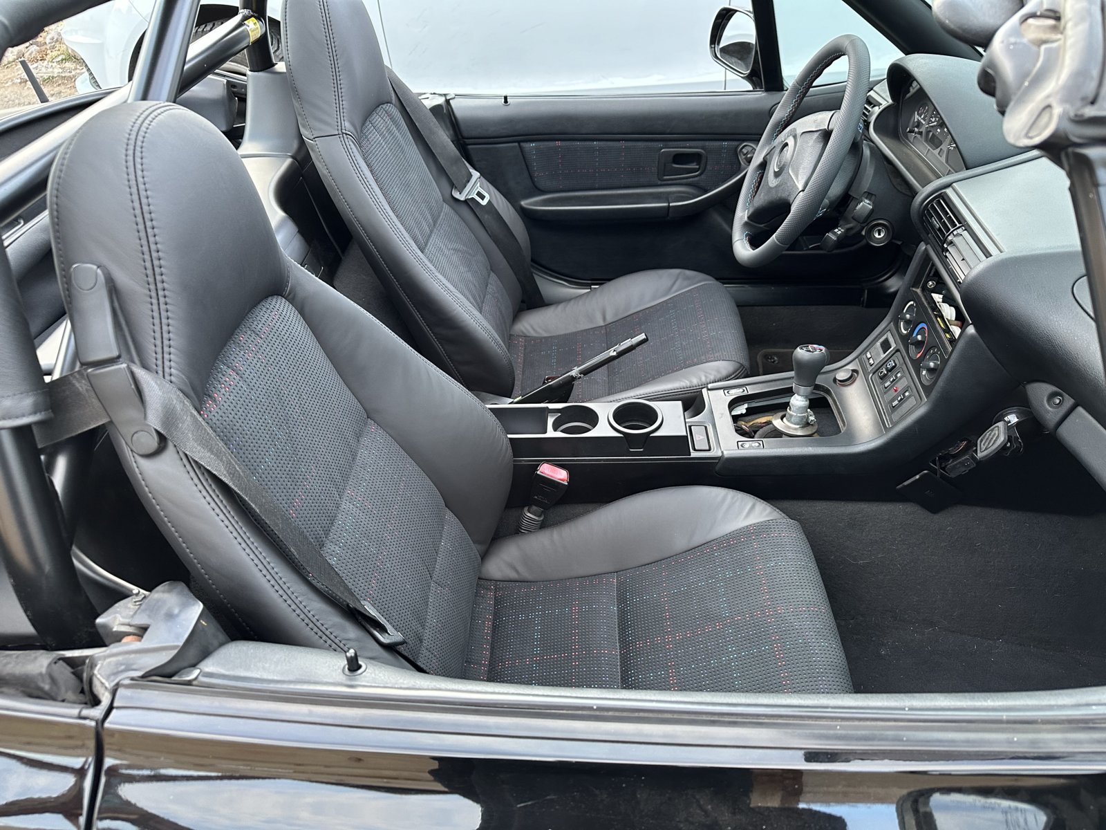

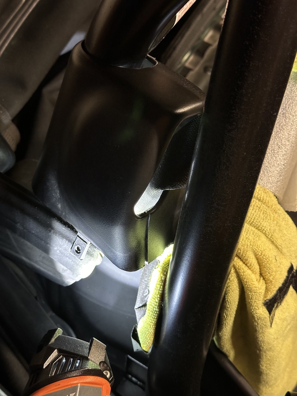

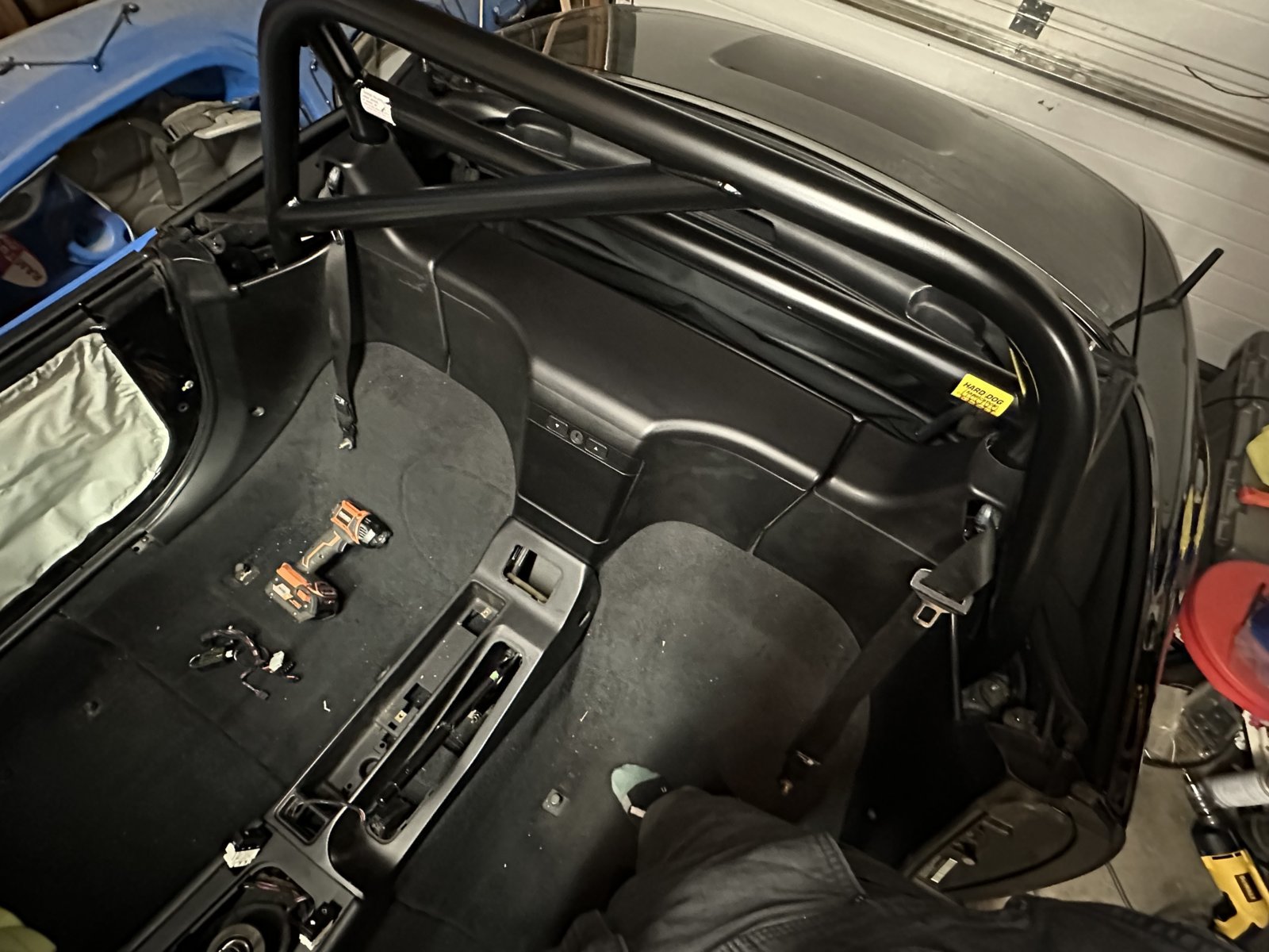

    Roll bar is in and interior trim pieces are reinstalled. I just need to vacuum the carpets and then the seats can go back in.
    I had to take the dremel to a couple interior trim pieces but it is in areas that you can't see when it's all assembled.
    I want to use the heat gun to work the leather and see if I can get a better fit. It was late and I didn't feel like dealing with it.

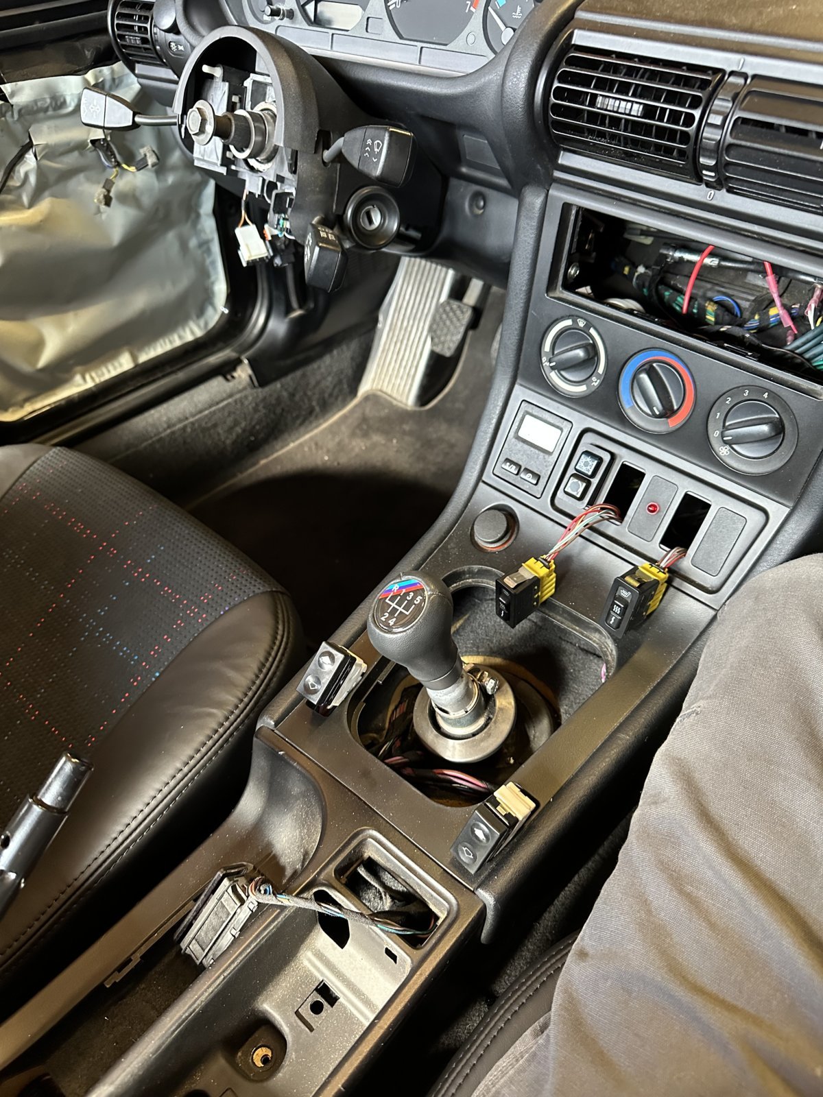

    Seats are back in. Waiting on a part for the M3 steering wheel swap that's scheduled for delivery this weekend. Once that gets here I'll be able to pull it out of the garage to open the doors wide enough to install the door cards.

    It's coming together. Got it out of the garage for a drive this evening. Still waiting on parts to finish the M3 steering wheel install...looks like they won't be here until next week.
    Hopefully the boots and ebrake handle will be done in the next week or two. In the meantime I'll get the stereo back in, give it a bath, and maybe start on the paint correction.

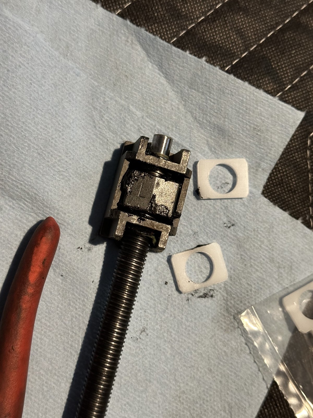

    Before the seats went back into the car I replaced the rubber seat rail bushings with some derlin bushings. The seats moved a good 1/2 or more under braking and throttle because the old bushings had turned to paste.

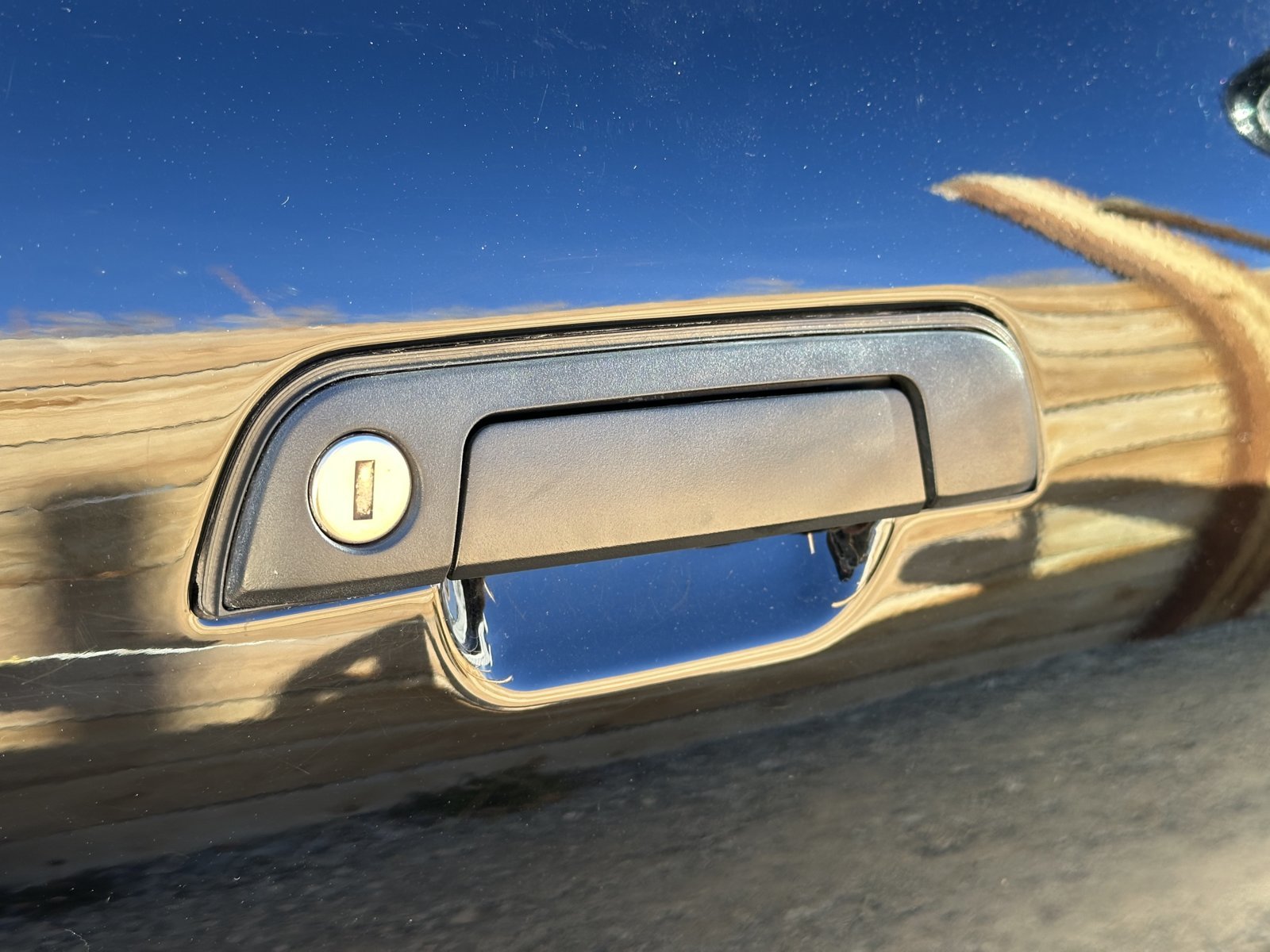

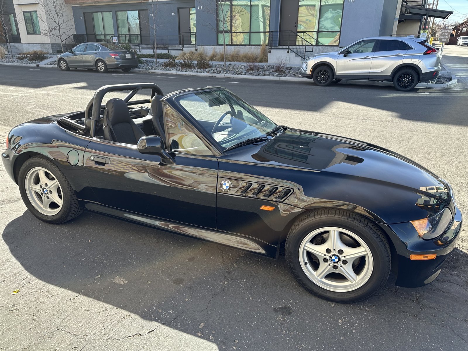

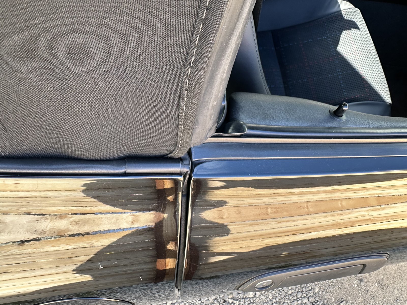

    We had a few days of nice weather so I took advantage of the clean, dry roads and got the car out of the garage for some top down driving. Between the old suspension, the 12 year old tires, and the 40° temps things were interesting in the handling department. The car was super twitchy when cruising. When pushing it a bit, the understeer was more evident and the back end more jittery than usual. I'm looking forward to getting that sorted.
    I've checked a few small items off the list, including replacing the rotted door handle gaskets.
    I also replaced the plastic caps on the ends of the top seal just behind the rear of the door frame...they've been missing for at least 20 years.

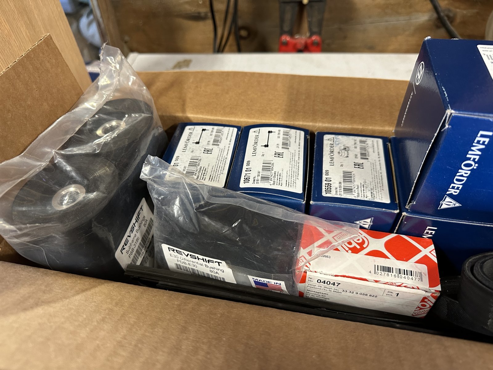

    Now I'm back to collecting parts for the suspension refresh. It's going to be a mix of OEM rubber and 80A poly for all the bushings. I have new lower control arms that will go in as well. I still need to decide on struts or coilovers and purchase a few more miscellaneous parts before I start pulling things apart.
