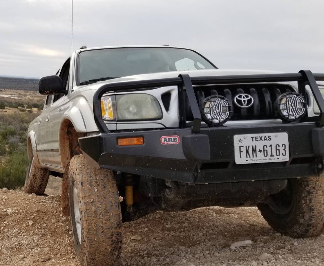

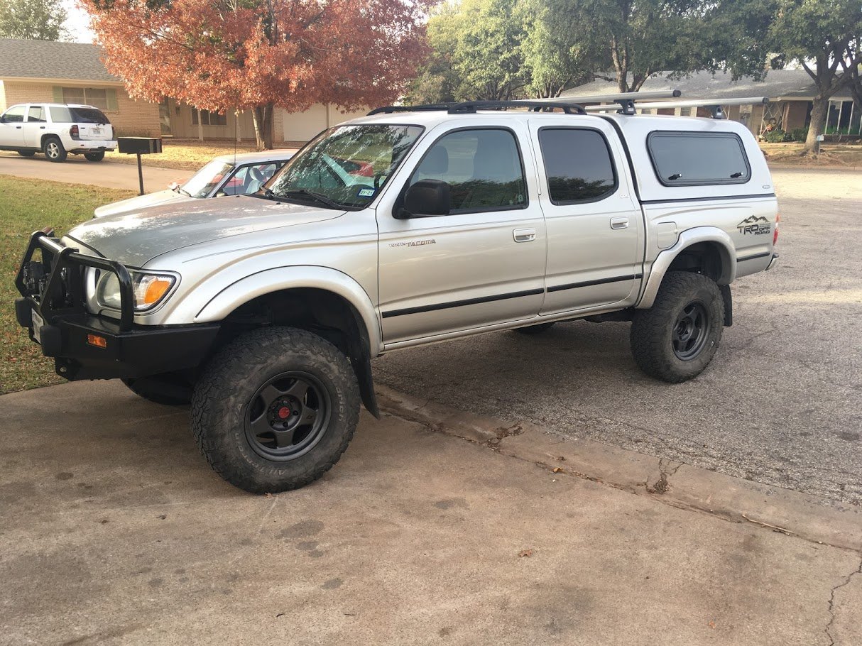

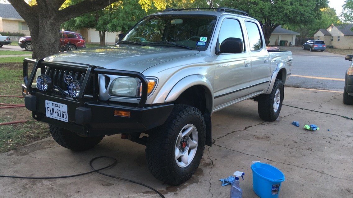

    Here is my mess of a build thread. The truck was successfully converted to 4WD in November 2018. I've been daily driving it since and have taken it wheeling three times.
    Intro
    Bought this truck in December 2016 bone stock from a retired guy. It had been maintained by Alamo Toyota in San Antonio, TX that sold it in late 2003. I do all the maintenance on it now. It is a 2004 Lunar Mist color matched SR5 double cab PreRunner without a rear locker and a dealer installed roof rack. The truck was at ~109,000 when I bought it. I'm at ~135,000 now.

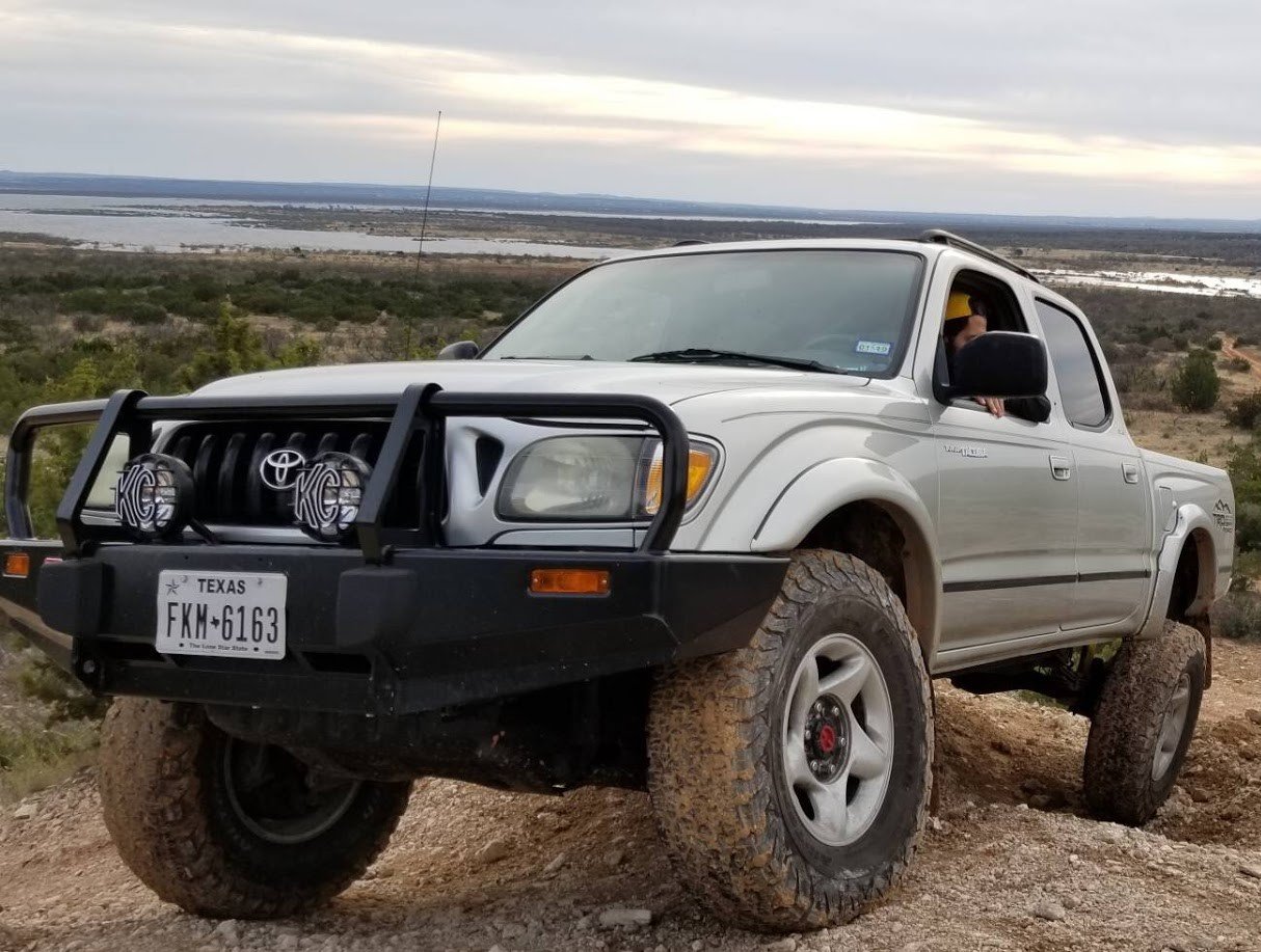

    As it sits 12/20/20.
    As it sits on 4/21/19. Skid plate removed for front diff inspection. Cleanest it's been since I bought it.
    FxzsW1kV5SFE851yXDkra2r830fBrBq59f_U-nKu_a821334607a05e3c6bf0f0466c3048a398ecda06.jpg

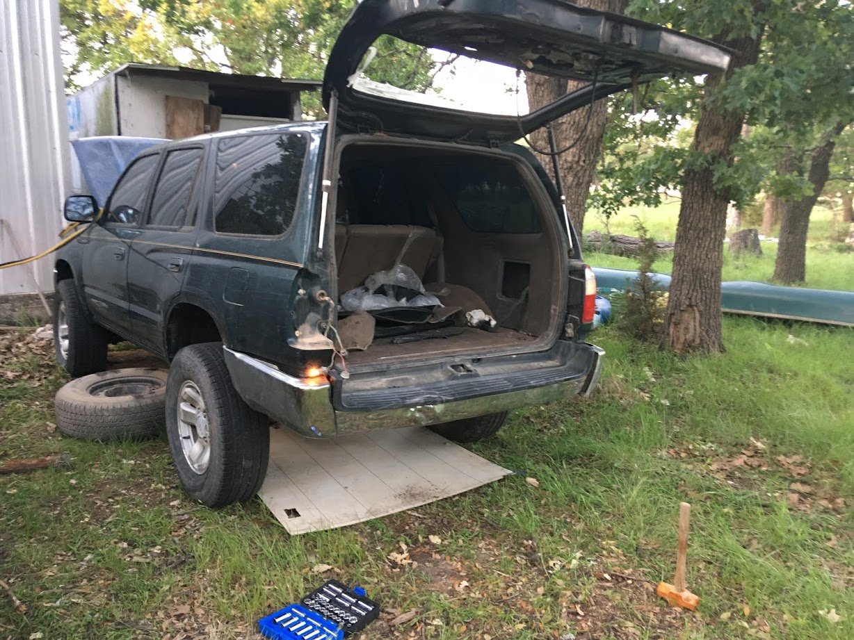

    As is sits after a summer of wheeling and a wash before winter. Camper has been a nice addition.
    My first picture of it was a blurry vertical Snapchat so here is the first horizontal. Truck hadn't changed since I bought it.

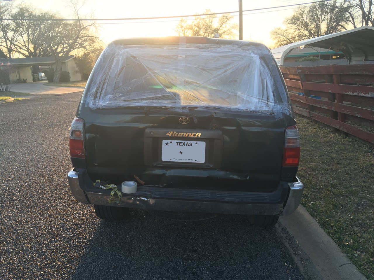

    4Runner back window has been covered until I get a 3 day weekend to trailer it. Also trying to find someone with a trailer I can borrow. Uhaul is expensive.
    10/10 tape/drop cloth cover. Never thought I would ever be in the position where taping up a window was necessary. If someone breaks in I hope they leave me the Pioneer radio....
    9RJUUdJUgaytaO5__JjkSDGzH8_jR4Ud98jZSgiQ_25ad7ec19c59b90537c0b02a17043b847e283519.jpg

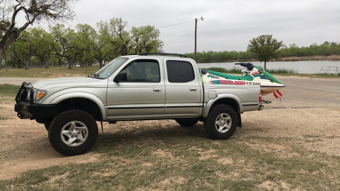

    My buddy convinced me to help him get his jet ski purchase out for testing. The truck handled it better than I expected.

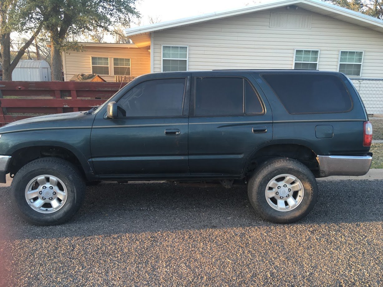

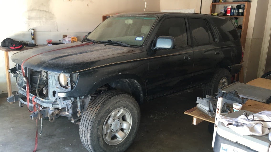

    4Runner has arrived at my friend's shop. Crawled around under it but didn't have much time to mess with it before I had to head back.

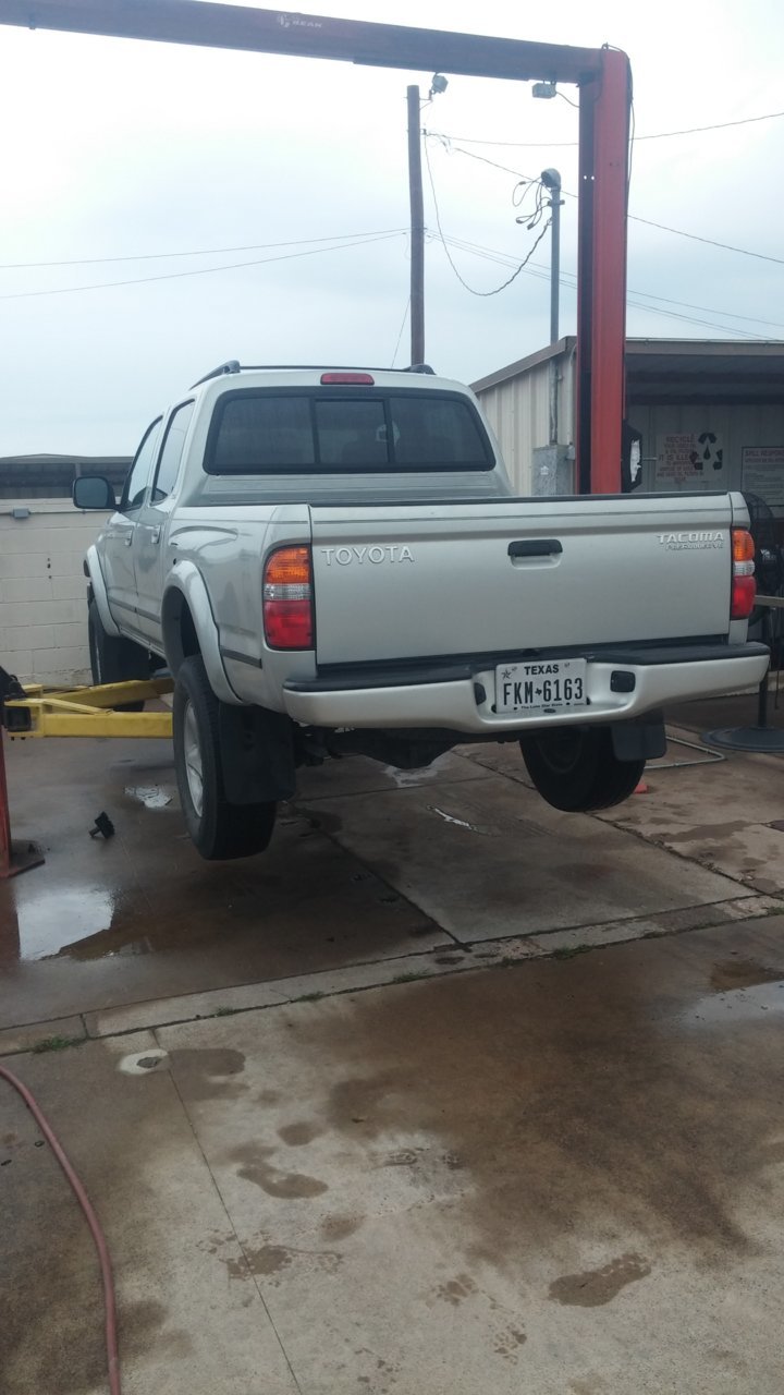

  14. Jul 26, 2018 at 10:58 AM
    04Pre_Runner
    04Pre_Runner [OP] Well-Known Member
    Feb 9, 2017
    #210143
    4,903
    Andrew
    2004 DC Tacoma SR5 4WD V6
    Q7cBZGGVupTtf9XGpH7VRZOLKricC3MahjCuXxoq_d36f7de25d3d245f822b0781f5894dcd105af1e7.jpg
    Stripping it this weekend. Behind schedule but summer classes and 40+ hour work weeks will do that.

    Dropped the trans, tcase, and engine in the 4Runner tonight. Started at 3pm ended at midnight. Will get detailed pics up tomorrow and figure out what needs to be done in preparation for my truck. The plan is to be driving around in a 4WD Tacoma by the first day of fall semester on the 27th.

    Parts have been pulled from the 4Runner. I have the funds and there is an availability of parts right now for me to get any items I can't use off the 4Runner. We pulled the engine, tcase, and tranny all at once and cut a support to make it easier. The truck is being scraped so it doesn't matter. I just need parts to be identified as compatible. I haven't pulled the front diff yet but it's coming off on my next string of days off from work.
    I know the transfer case is j shift but I'm still a bit confused on the compatibility of the front diff and hubs. I know the bearings/hubs/seals were replaced in around 2013 (owners manual has receipts for some labor done on the vehicle) so that would make them a good candidate to press out and press into my Tacoma spindles. If they aren't damaged. I've watched enough videos on YouTube (like the Timmy The Toolman 4Runner video series) to try and not break anything pressing them out. But if they aren't even compatible with my manual locking hubs then I don't need to bother with them. Which leads me to a question on the front differential. If my 4Runner is j shift without locking hubs is my diff still ADD? And if so do I have to buy a front diff off of a locking hub Tacoma? I'll post pictures below of the parts in question.
    Passenger CV axle. Boots aren't terrible. They were most likely replaced since 1996 but I can't be sure since the owners manual doesn't have 100% of the maintenance records on the truck.
    Front differential is leaking. It is the matching 4:10 (still unsure about the ADD situation) to the rear on my Tacoma but I can buy a different one with less mileage from a guy here on TW. As well as purchase one from a yard if that doesn't work out. Or I could pay for a rebuild. But I do need to figure out if mine would even work for a manual hub 4x4 conversion at all.upload_2018-8-1_19-29-50.jpg
    Transfer case is fine besides a bit of a leak. It shifted fine before the engine died. I do plan on opening it up and doing the seals/check for any issues.
    Once I have all the parts/fluids/mounts/etc prepped and ready to go I will pull the trans from my Tacoma and have a shop swap the output shafts as well as put the tail housing and oil pan from my 4Runner trans. I'm having my driveshaft cut at the same time the transmissions are worked on. My debit card got hijacked today so I can no longer order some of the things I had planned on. Won't push me back too far since my next day off it Tuesday.
