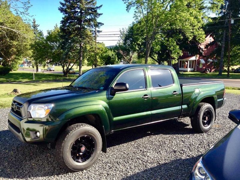

    Love the green long bed. Couldn't find one when I was looking.
