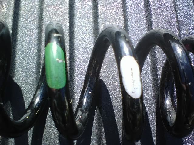

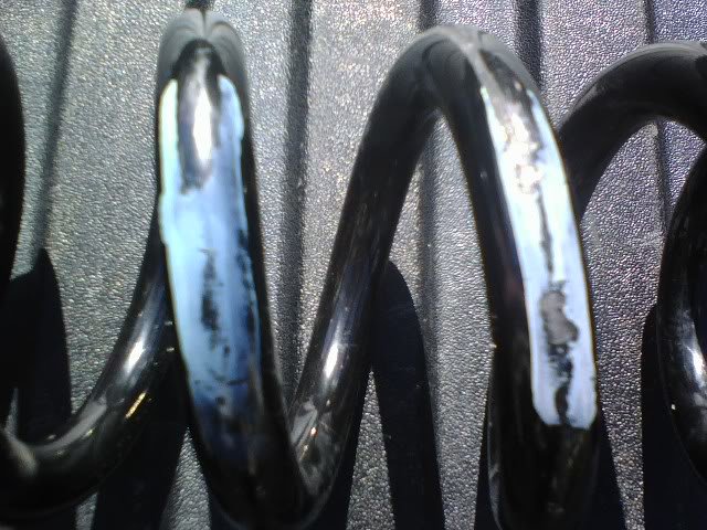

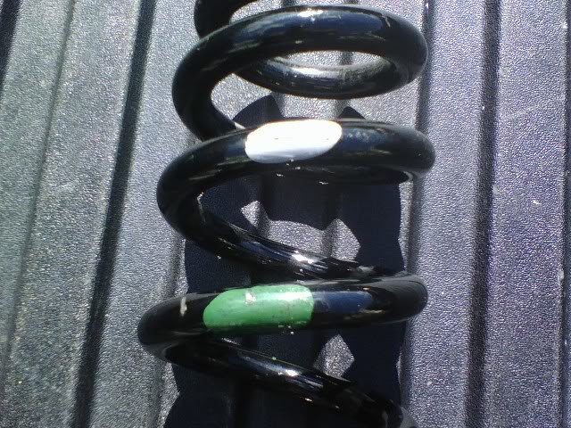

    Grivera, hope these are the colors....
    ok so those are the two sets of colors, just need to know which ones go on which side.
