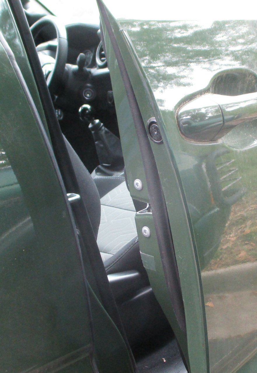

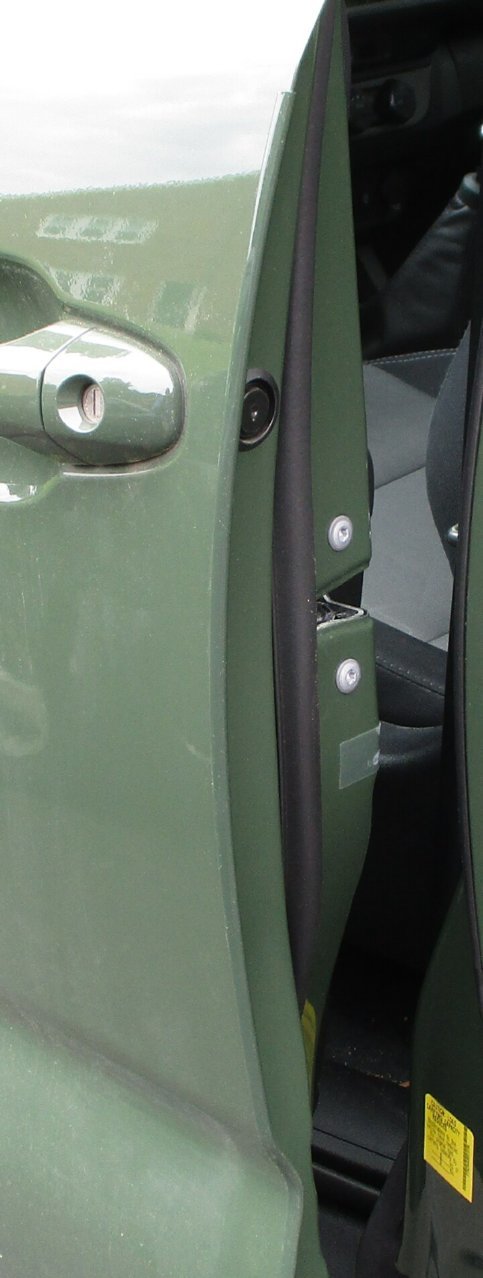

    When I installed my edge guards, one side went on easily. The other side had the problem that you describe. I got one of those little tubes of super glue gel and applied a little inside the top foot or so of the edge guard channel. Tapped that in place and held it until the glue set. (Somewhere between 5 and 10 minutes.) Then did the same thing to the bottom foot or so. Use this stuff sparingly, because if it squeezes out, it will leave a white residue on your paint. Then you will have to carefully remove the residue with a razor blade and a toothbrush.

    Why would you remove the moldings? I've had the original edge guards on my Ford Ranger for 23 years with no problems.

    The Toyota edge guards are metal. Not like the cheap plastic aftermarket stuff.
