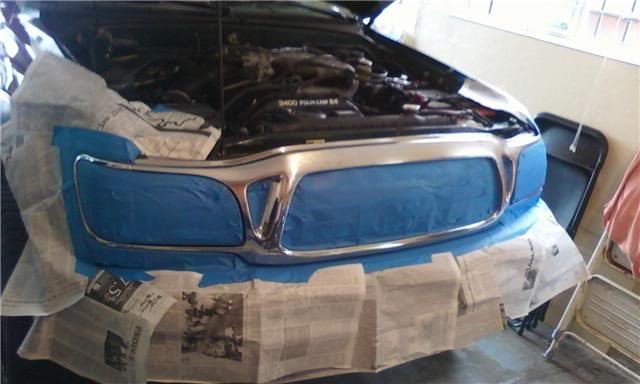

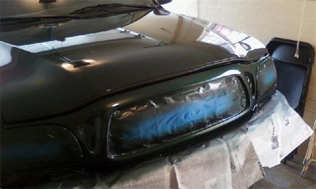

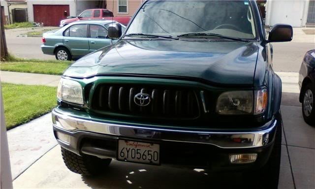

    I just color matched the grill of my truck! came out pretty good. I went to a local paint shop and had them mix paint to match factory color in a spray can for $30, they used PPG paint. one of the best out there. color matched pretty dead on.

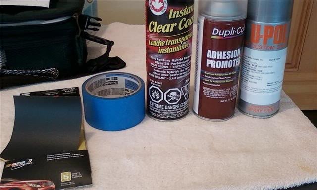

    heres what i used(in order):
    400 grit sandpaper to sand it all down, adhesion promoter to make the paint stick, 3 coats of paint, 3 coats of clear
    taped off everything except the grill surround. takes time and patience..Do this first! sand everything down well. clean it free of dust. apply 3-4 coats of adhesion promoter
    add the coats of paint
    add the coats of clear
    let it dry for a bit then take off the tape carefully as too not scratch anything. once its dry to the touch, take it out and check the paint and let it bake in the sun.

    That looks really good. It was easier to tape off the entire front end instead of taking it off the truck to spray?

    Nice job on that Green Tacoma there. Although I must say it would have been quicker and easier if you would of just took of the grille, literally takes all of 5 mins. to do.

    thank you all! i had planned on taking off the grill but decided not to.. i had already started sanding and such with it on. lol. it came out wayyy better than i expected. after wetsanding and polishing, it came out even better than the factory paint! no orange peel. now the only thing that bothers me are the rock chips on the hood in comparison to the fresh paint on the grill haha
