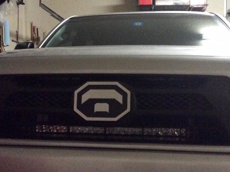

    This is the DIY short version.
    On my 2007 there are 2 bolts that hold the grill down and two plastic clips on the head light bracket that hold the grill in. Pop those off to get the Grill off your truck. Then there are a bunch of plastic tabs that hold the two pieces of the grill together. They are plastic welded or melted to hold grill together. I think you have to Dremel them out.
    The Rubber weather stripping is just held in by little plastic things. You can see how they are held in after you remove the grill from your truck.
    Paint it yourself or get it painted.
    Reassemble.
    Here's mine.
    The easiest way is to just buy a color matched one and just swap them.

    You just paid how much for the truck? $187 is suddenly bad?
    O.k... Did I mention the 15 minute install?
    Then you can pay more money for a new emblem like the cool kids.
