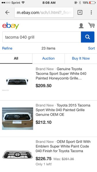

    A lot of dealerships sell the color matched (factory) grill on eBay, weird I know but that's how I got mine! (super white). Just find out your trucks paint color code (super white is 040 like you see in the picture I attached) Really easy to tell when it's a Toyota dealership selling one or not. You can try that. I tried painting/ plastidipping mine many times and it just looked off no matter what I did. But if you do go the route of just painting it, the grill is fully removable, just the previous guys said just look up a DIY and you'll find what you need.

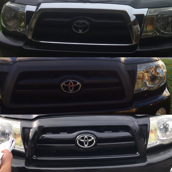

    I took a pressure washer to mine to strip the chrome paint off then had it painted at a body shop for $50.

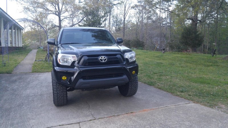

    Sprayed mine with Dupli color exact match.
    Don't skimp on the prep work and get some good primer.

    pressure washer takes chrome off??

    Probably his own high powered one. I doubt the ones at local car wash will do anything like that.

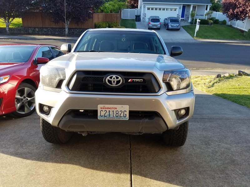

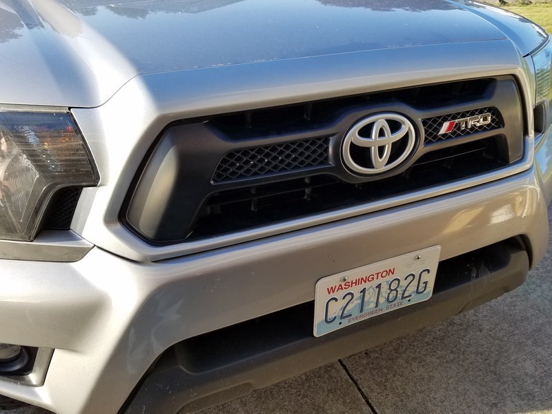

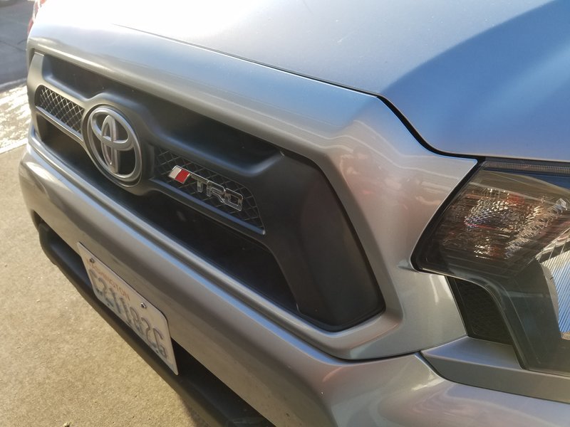

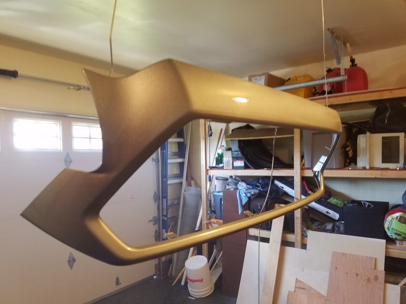

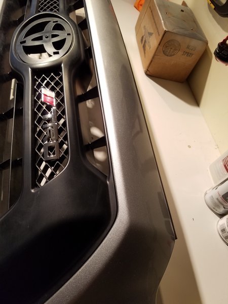

    Did mine this last weekend. I made sure to prep it well and used adhesion promoter. Then i did 4 coats of base and 6 or seven coats of clear. The finish is factory quality and i havent even buffed or polished yet. If you do it right it will look great and i am very confident it will last as long as the factory paint. I spent about 50 dollars and ended up with paint left over. I got the paint from automotivetouchup.com, and was very pleased with their products and service.
    If you hate the chrome grill like i do i highly recomend it. Just do the reserch to make sure you take the necessary steps to do ut right.

    Is that front plate screwed directly into the bumper?

    Looks great! Nicely done:thumbsup:
