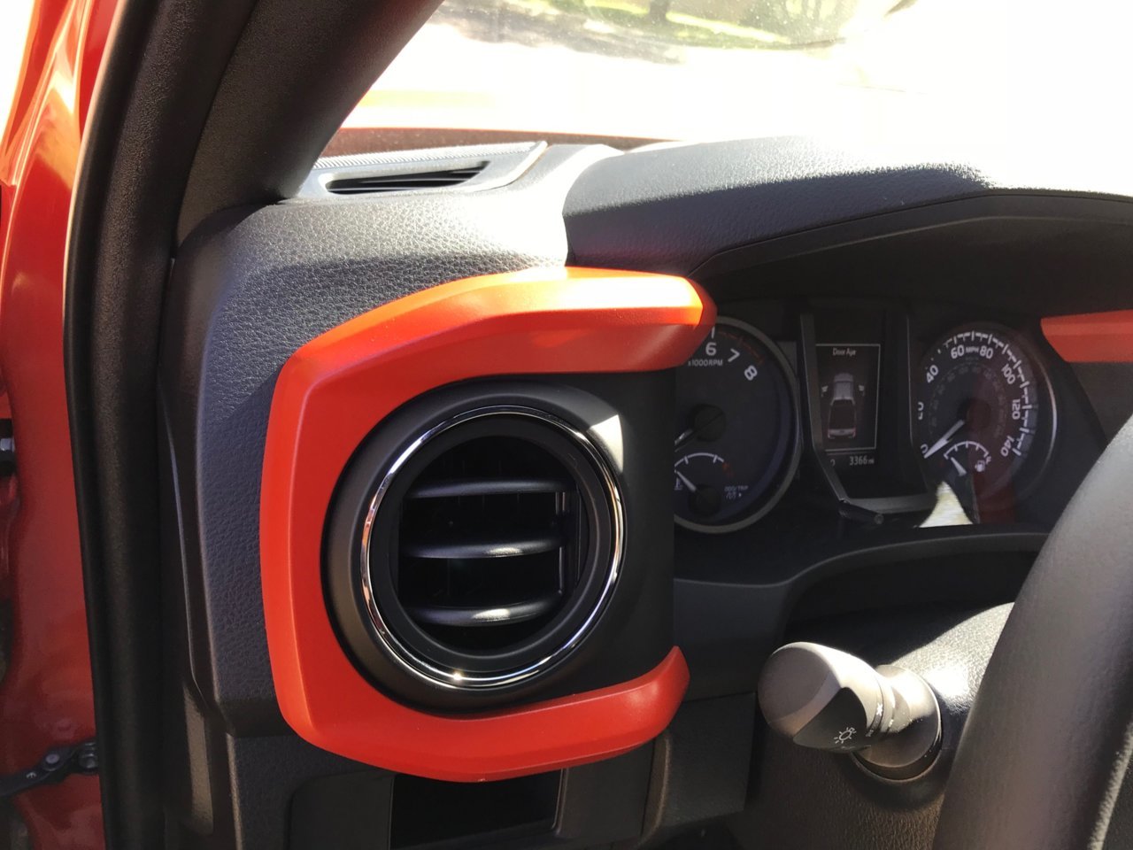

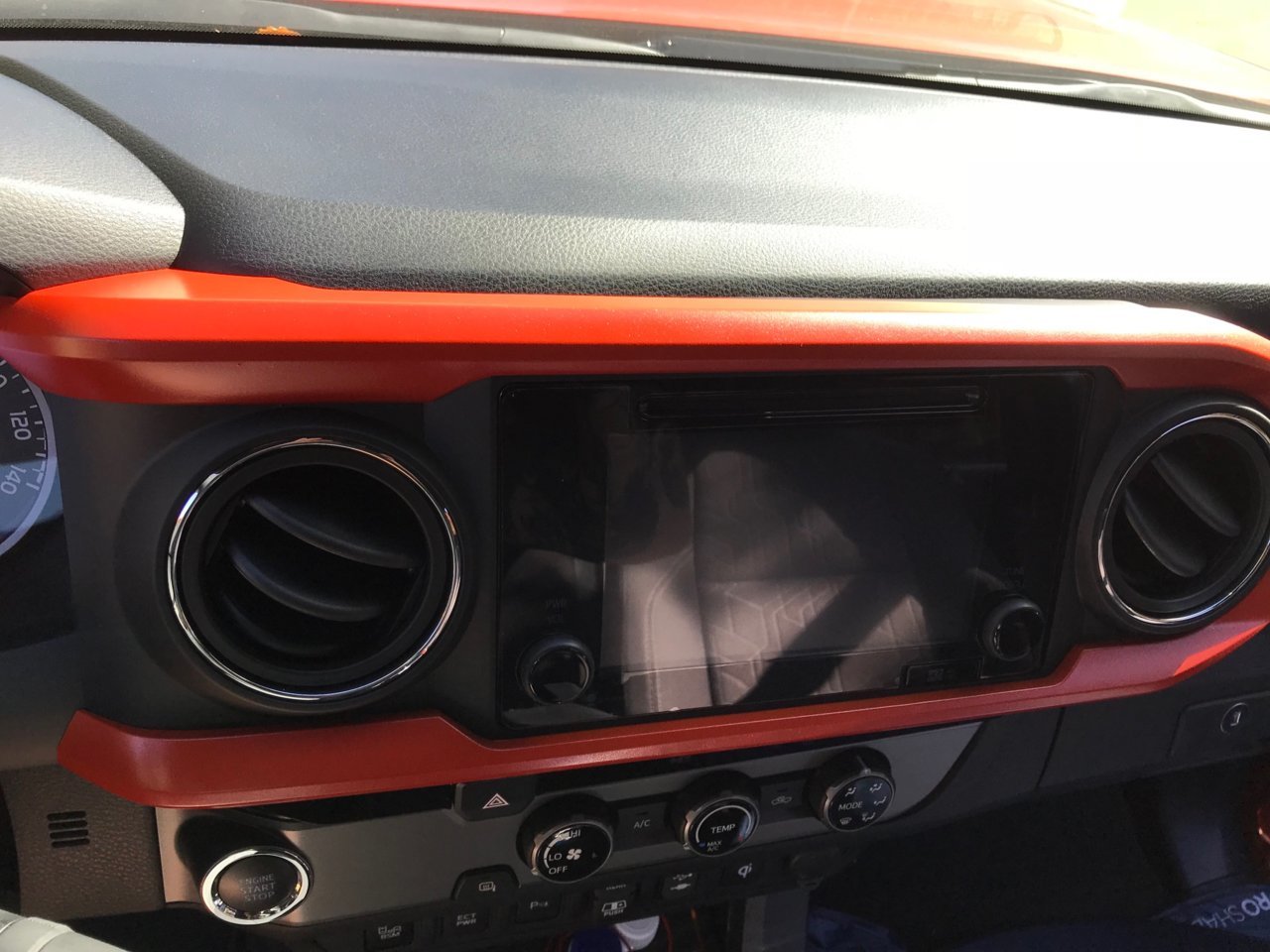

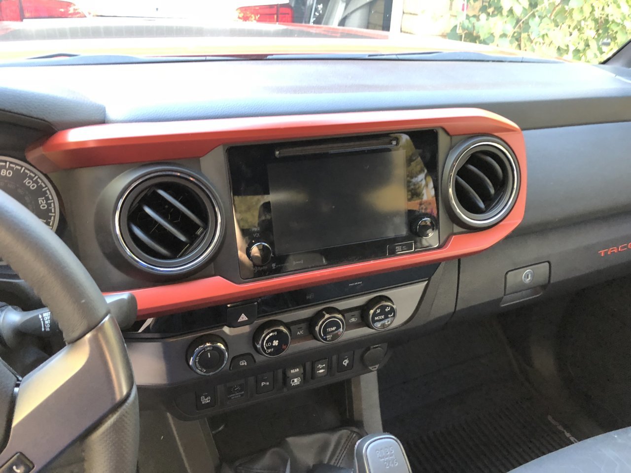

    Post up your color matched interior trim pics.
    Used adhesion promotor, color matched spray paint and matte clear coat from the home improvement store. Could use a sanding and recoat of the clear coat, but didn't have time before a road trip.

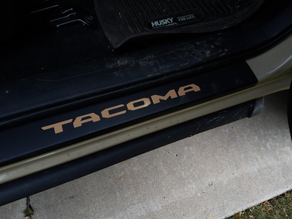

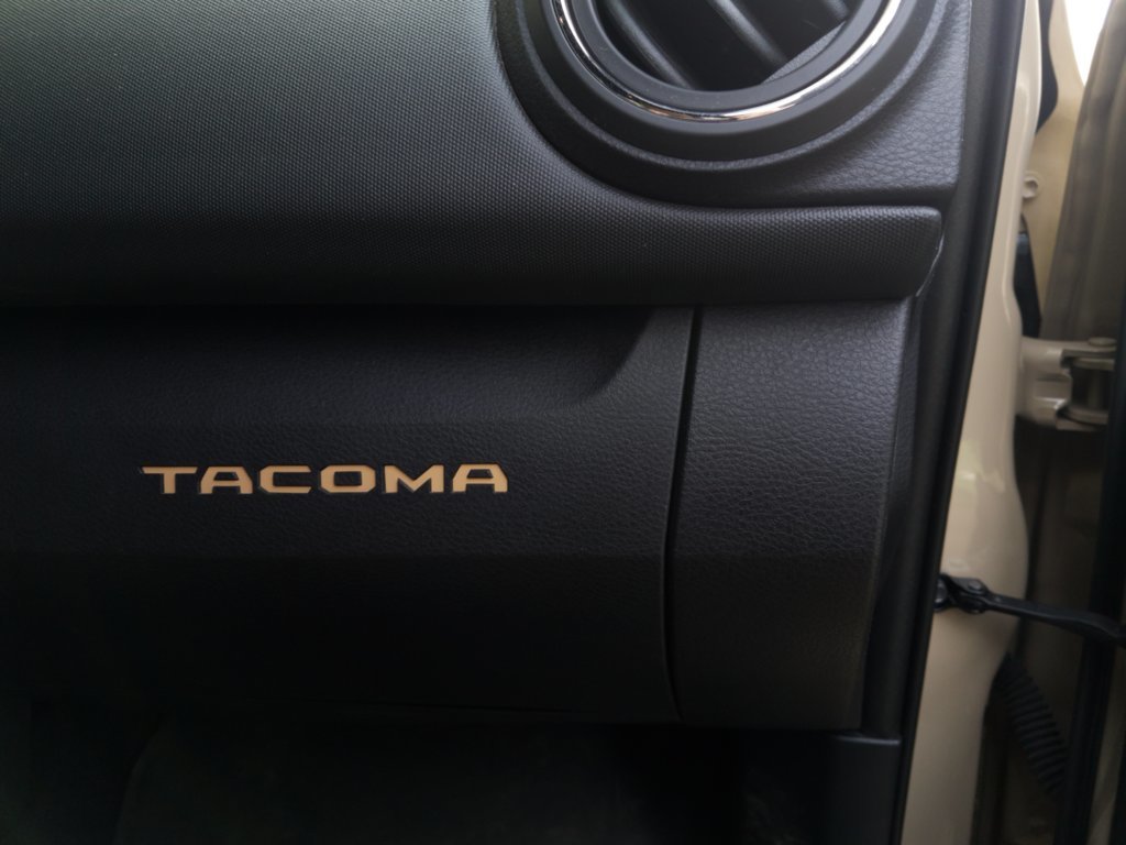

    Vinyl inserts in the glove box and door sills from http://tacomavinyldecals.com

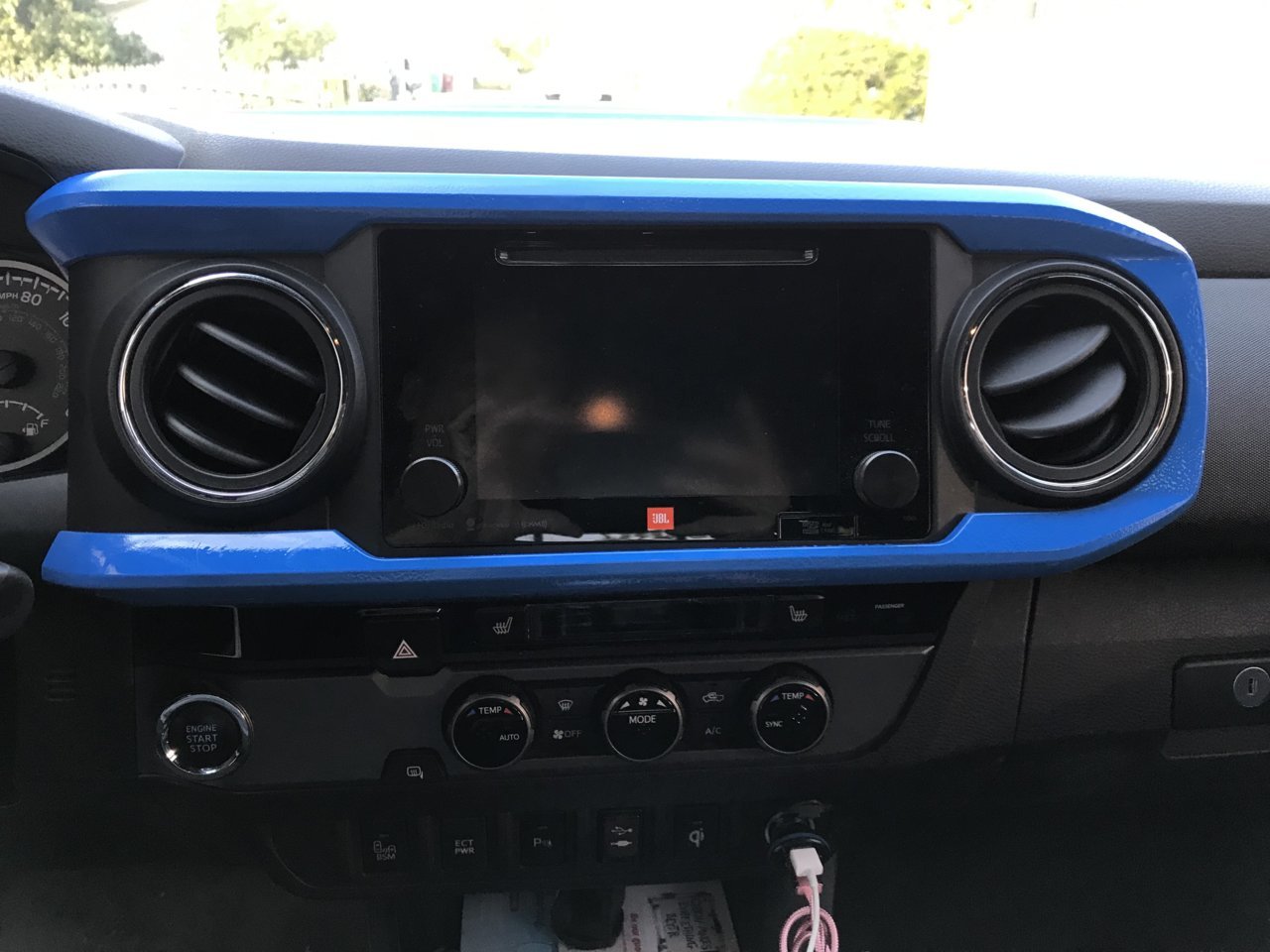

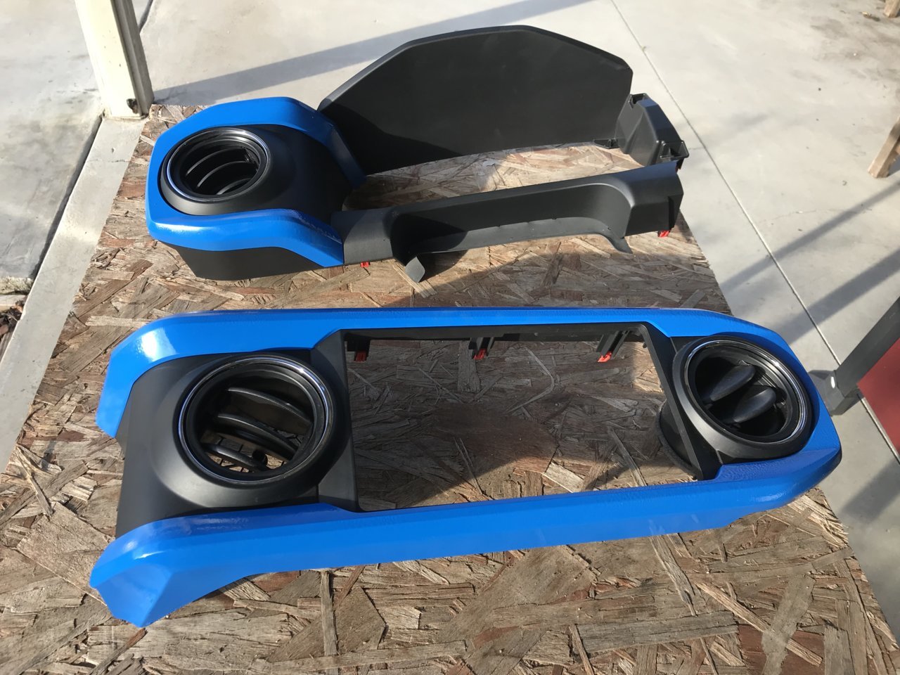

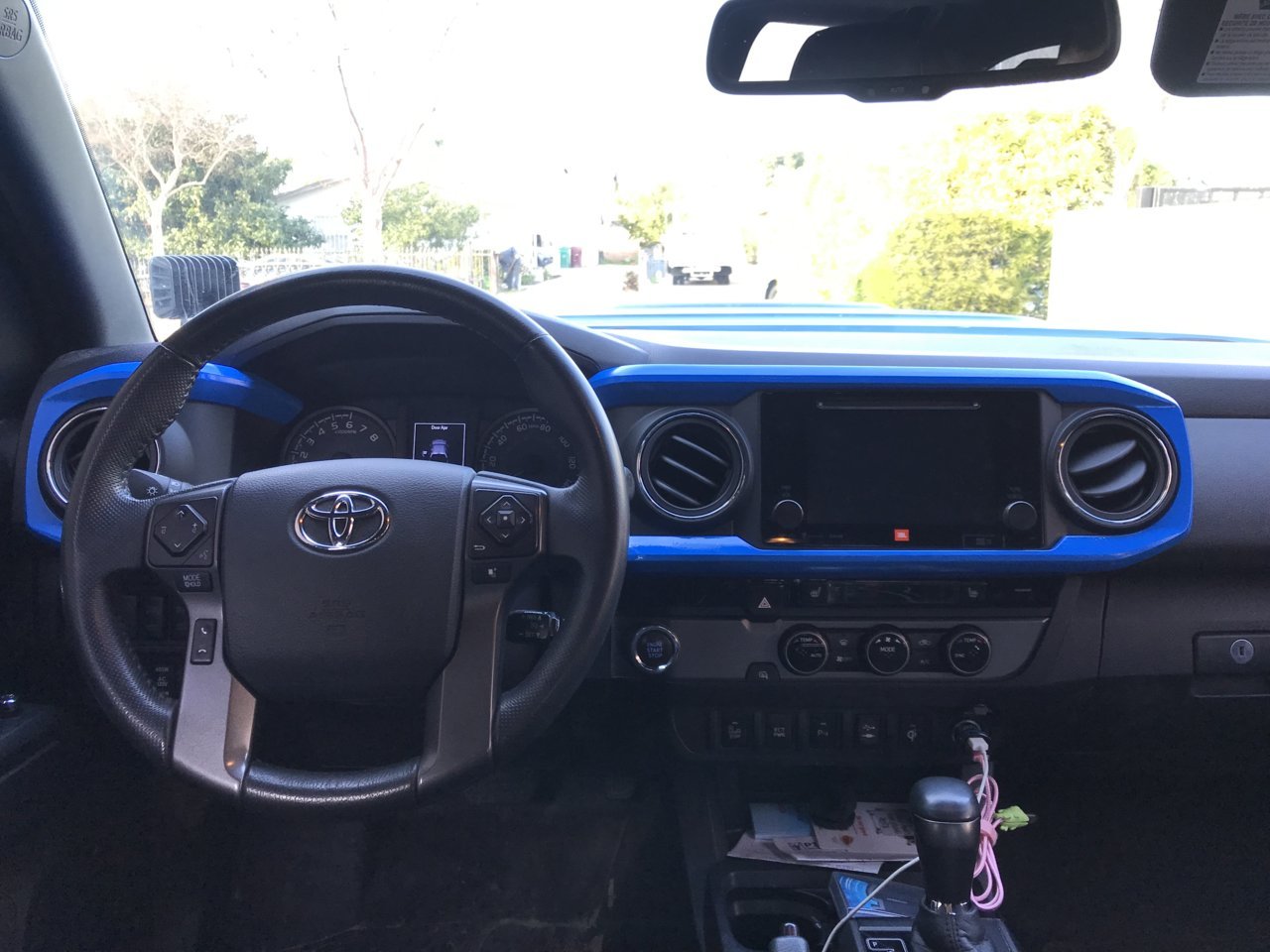

    I just used a spray paint from Home Depot. Primer/paint

    Looks really nice. Your post in the "what did you do to your 3rd gen today" thread is what pushed me to create this post. :hattip:
    Did the paint match the exterior color pretty well? Looks like it from here.

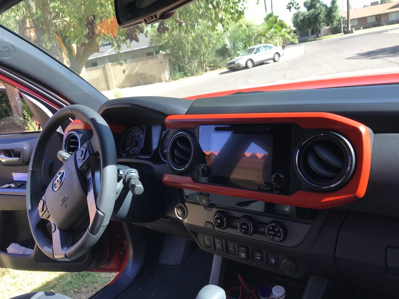

    Same here, Toyota made inferno easy

    Haha. Been wanting to do this a while now. The color does match it pretty close but heres a pic of it with the car. You can see its a bit more of a vodoo blue color.

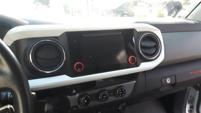

    Nice! What brand of paint did you use? Mind sharing your process?

    Used duplicolor. Super white, Nissan
    I took the dash/ bezel off and separated it all. Cleaned it with rubbing alcohol and just sprayed it lightly, let dry, light spray again... I think I did 4 or 5 passes. Took almost 2 cans. I didnt go all out as I wasnt sure I was going to like it. I do, so I just left it as is for now.

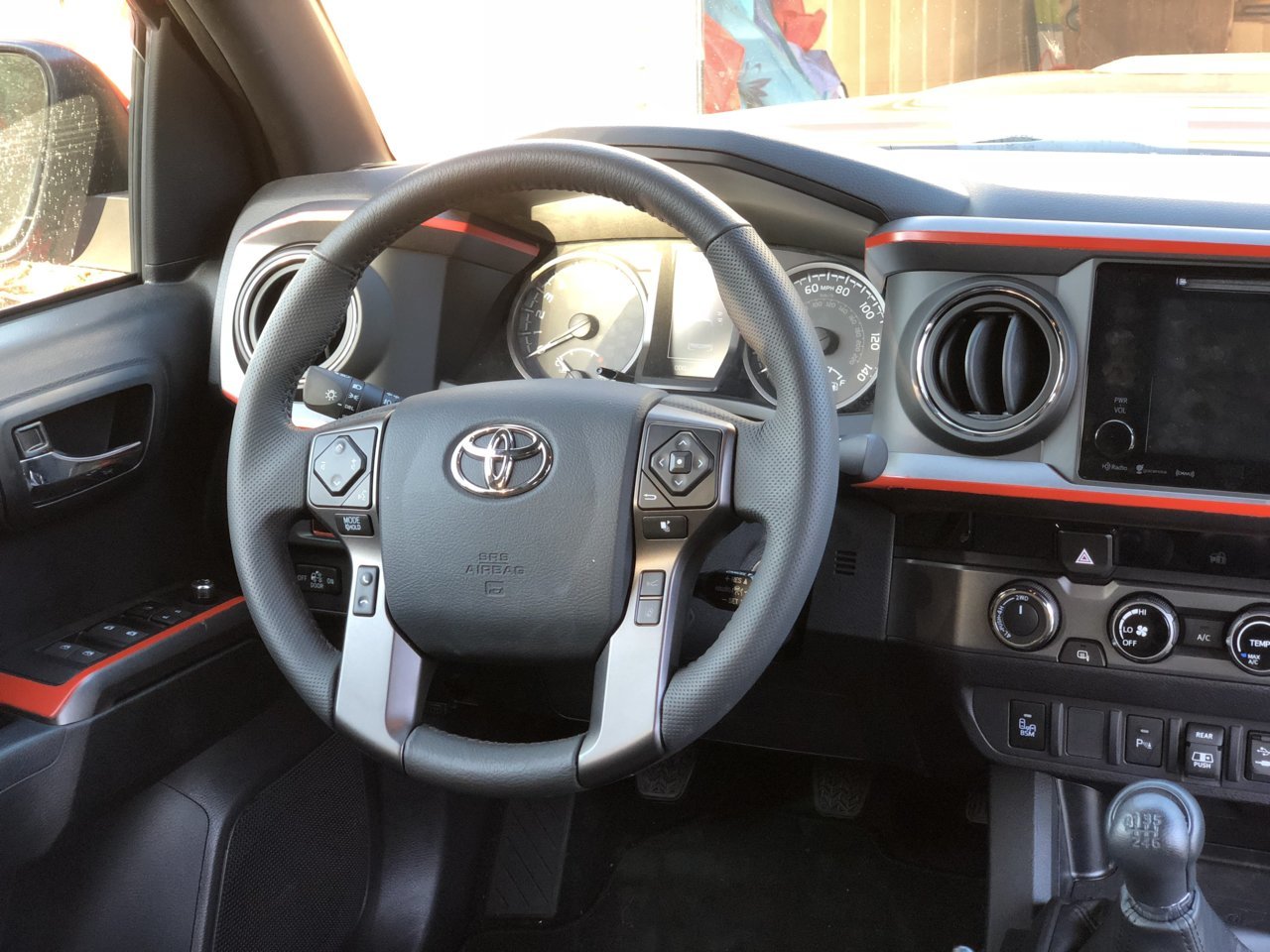

    935348F9-D501-4D95-A401-B1ECF2C937F2.jpg Went with a little subtlety for my inferno.

    where did you get those radio knobs? nice!

    They are silicone wedding rings. Get size 13... I got 14 and they are loose, fall off if I hit big bump.

    Thank you for the info. So I guess sanding is not required?

    Did you have to sand down the trim pieces?

    No sanding.
