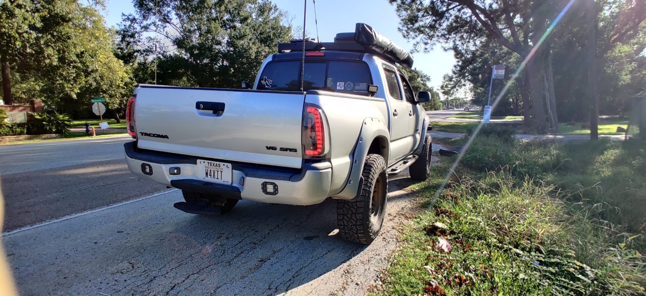

    Ensure you are using an acrylic lawyer paint with spraymax 2k clear.
    I paint matched my bumper and fender flares with automotive touch up paint cans on their website and spraymax 2k clear. It's a perfect match. Ensure you utilize adhesion promoter on plastic parts that will flex, self etching primer on bare metal and primer on other parts.
    A bit dirty but here's a current picture.
