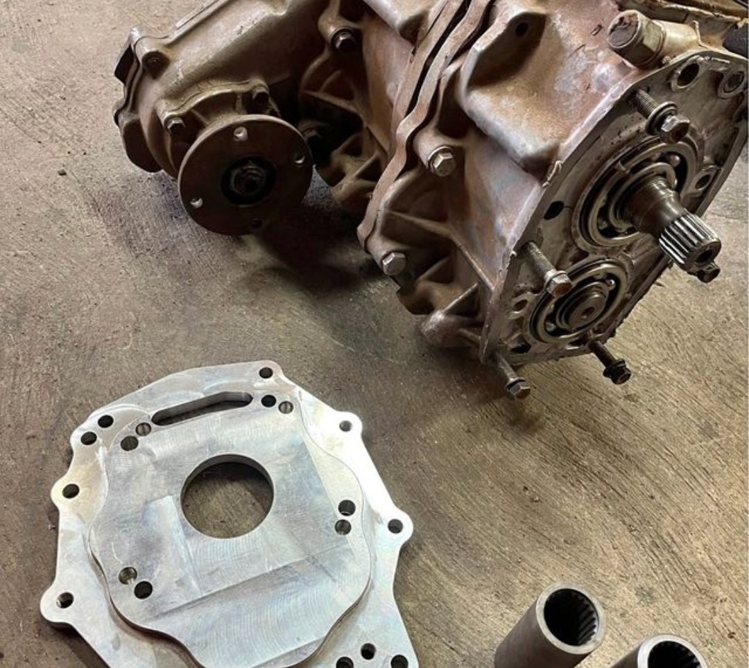

    Ahh apologies.
    clarity: this is both cases assembled. Two 4.7 gear box cases mated with a RHD driveshaft drop and the adapter for the transmission.
    e 198X-1995 models were rhd.
    I'm scheming and dreaming right now.

    Ahh I follow.
    Ok, so from that you only need to purchase an adapter plate to go from a gear drive to a chain drive tcase, and if you want triple sticks that too. You would want to verify that the input of the 4.7 case is a 23 spline, as you can get those in a 21 spline but our trucks require a 23 spline.
    A crawl box is hands down the best mod if you wheel technical stuff.

    Ahhh excellent. I don't remember spline count being relevant previously.
    I'd definitely chip for triples when I do it.
    Thanks for all the info!
    What would you price that picture at if you were selling it?

    That transmission adapter is about $350
    4.7s are ~ $700
    I think its a bit much $$ for what you would need off of it, it would have to be closer to $1000 to make it worth it.
    The gear drive to chain drive adapter is the expensive plate thats missing. Its about $800
