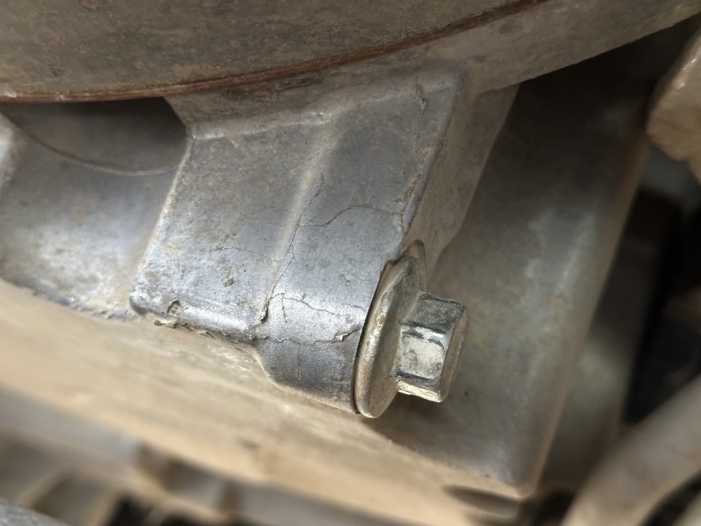

    Most likely casting. If they cracked it with an impact it probably wouldn’t be oil panning very well anymore

    great point. No leaks so I suppose just carry on. Very glad I’ve done all the maintenance on my Taco.

    Casting flash for sure.
    Get your blue or yellow bottle torch and heat that sucker up then lefty loosey!

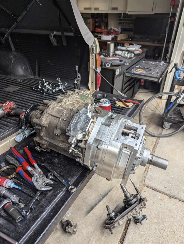

    Duals are in the truck and are operational. Pretty fucking cool.

    That's hanging off the tailgate.
    You gotta push it further into the bed before you can legitimately claim "in the truck" status.

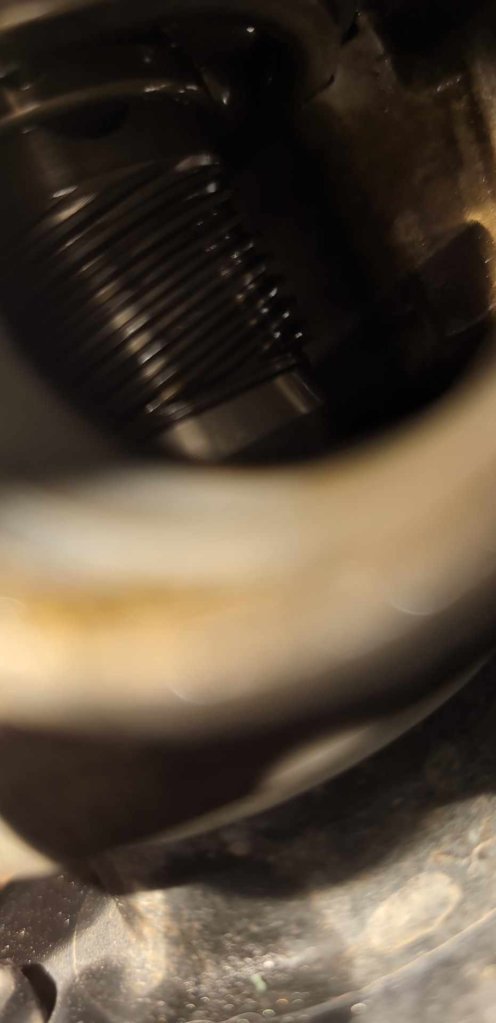

    I'm assuming your speed sensor is at the rear output of the tcase like mine versus at the wheels, and that you have that swapped over and plugged it in on the FJ case. If you've done that, i have 2 things to suggest:
    1) double check continuity through that 3 pin harness, especially if you extended wires. Somehow I had a pin go bad on mine and had to replace the harness.
    2) make sure your FJ case has the worm gear on the output shaft that drives the sensor. Depending on what truck your fj case came out of it may or may not have had it. I would think it would be difficult or impossible to install the sensor if the worm gear were missing, since it would be hitting a smooth shaft versus a grooved sleeve, but it's something to check. If you pull the sensor and look through the hole, you should see the wavy grooves on the shaft. If it's smooth...I got some sad news for you....

    It's got the windy spinny thingy on there

    Awesome! It should just be a wire issue then. No reason for that sensor to go bad from moving it between cases. At least you don't have to pull out the whole damn thing again.
