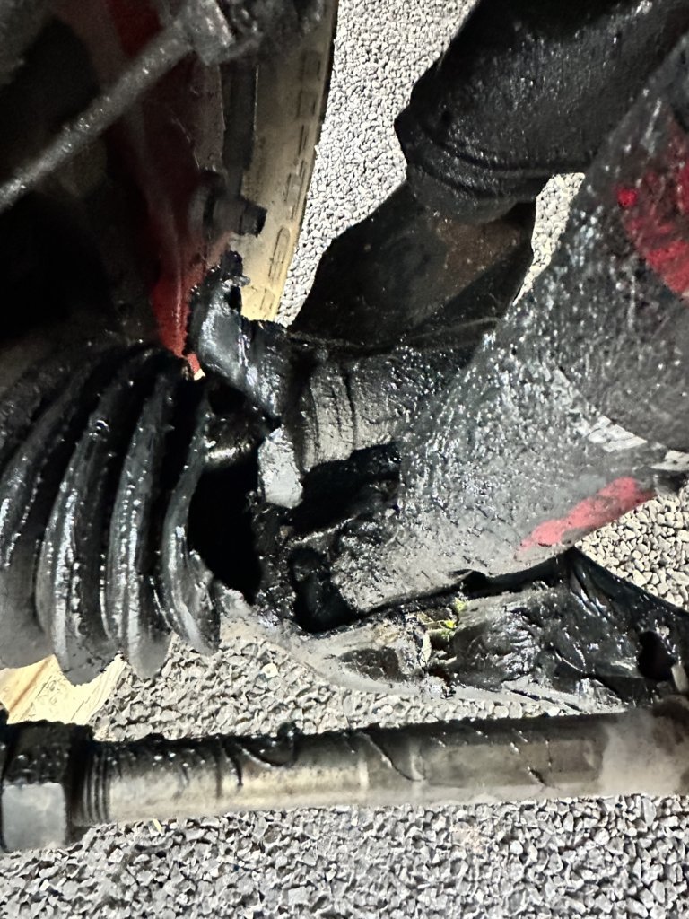

    Hoping to cash in on some karma on this place lending out stuff and doing some TW Express…
    Two things:
    1) How do you know if a CV with a ripped boot can not be salvaged? I drove somewhere between 20 and 60 miles on washboard in sand/dirt yesterday when a torn outer boot. It looks like most of the grease has been ejected but it’s not too dirty in there yet…
    2) Help requested for Junction today to source and swap in a new/used 2nd gen passenger CV.

    You know if the CV is bad if you hear *crunch crunch crunch crackle crackle pop* when it turns and the bearings fall out. I've seen guys run days with torn boots and the CVS held up

    Take a close look at the needle bearings when you get it apart. I was going to reboot one years ago that had a few broken needles (less than 5) that I decided wasn't worth the effort and putting back in my truck. It was working fine, not making any noise, and probably would have been fine for many more miles until it would have inevitably blown up doing something stupid on the trail...likely how the needles broke to begin with.

    So if it’s not making any noises, should I just drive all the way back home to the front range and assess then?
    this is angled down view from front of the truck:

    You'll be fine, send it back to the front range. Use it for a core at CVJ and get the OEM boots on the replacement.

    Thanks for the offer. I’m going to just head back home since others reduced my worries and I’d rather see if I can just reboot this rather than toss a parts store CV at it.

    I ran NAPA CVs for a long time with a spare in the truck. If broken, NAPA would replace, but I looked up to see their current warranty and the boot tearing voids it ha. They used to take them with just a torn boot
