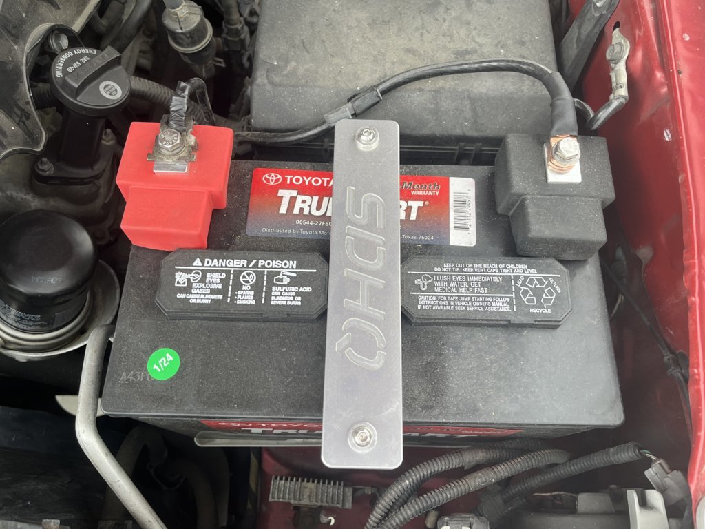

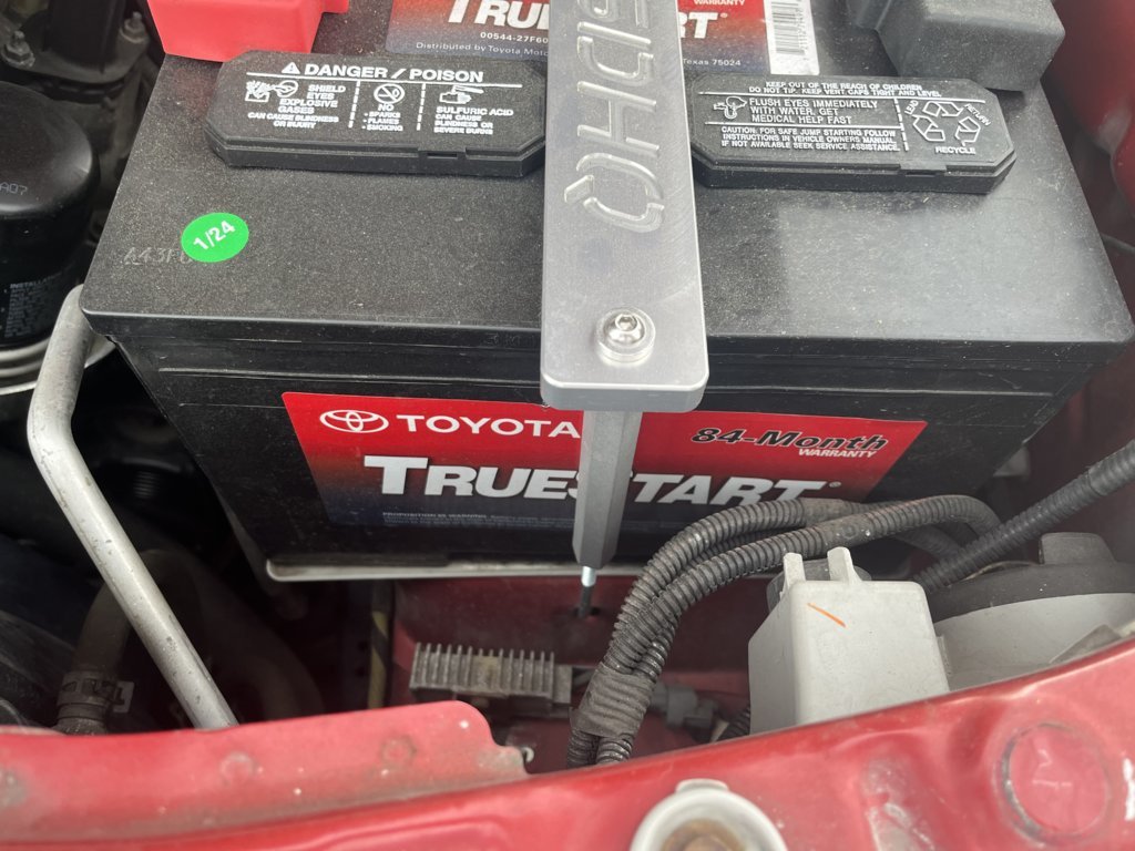

    HELP. I'm coming back from moab -to SLC for the weekend. I did hells revenge in my 3rd gen bounced on some rocks. Handled it well without issue. Now all of the sudden today I'm driving and the truck is losing power like crazy. Happens when I brake on the hwy. The radio shuts off and reboots, the christmas tree lights up, then the dash also shuts off completely.
    Only change is doing a r4t battery upgrade. If anyone has had a related experience/ solution let me know.
    There isn't a single thing that looks out of order under the truck.
    Would a bad alternator be a possible culprit?

    @ShiftyShank scan and pull any codes? Unplug the battery negative for 30 min, plug it back on and does it replicate?

    No CEL, no codes to pull. Did unhook for 30 min re hook.
    I just removed the R4T terminals and filed out my leads to fit directly to the top of the battery. Not counting my chickens till I make it to SLC. But maybe these posts are faulty and shitty?
    The "brake pedal dimming dash/christmas tree" eval says things are OK for the moment.

    Those plates have a few pieces of hardware to keep tight. I can’t say if the quality, but they sure are not SDHQ pieces.

    I drove all the way to SLC without issue. I had those plates snugged up proper on all accounts. I'm not impressed or happy with r4t right now.
    We will see how the drive back to CO goes lol
