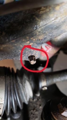

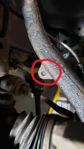

    Seeking some answers from all U all. What is the bolt size and thread specs for the Brake line junction (hard line meets hose) holder on the driver side spindle of a 2002 T4R 4WD?
    As for bolt extraction I am proposing sourcing the correct size nut and attempt to extract from the backside by turning the nut righty-tighty. As u can C it's a bit rusty though so I foresee failure in my future. I do have bolt extractor bit as next step.

    That is a perfect, textbook drill out candidate. Center punch it, spray it, drill it. Heat from the drill bit will prolly cause it to unscrew itself out.
    Otherwise, I wouldn't bother with a nut, just vise grip that stub and twist away.

    I would just grab some vice grips and spin it out from the back. Or double nut it if there's room.
    I think that has a 12mm head, so M8x1.25 bolt. I don't think length matters too much, but I would guess it's 20mm.

    @Deathbysnusnu and @Squeaky Penguin - Well, the vise grip method failed to budge the seized broken bolt. So, I just drilled the bolt out. Hole is sitting at 9/32". Good enough to find a bolt and nylon lock nut to hold the brake hose clamp bracket. Besides the ole girl could use a little SAE hardware just to screw with the next owner - whenever that day comes.
    Now I'll wait for the new brake hardline #6 to show up at Stevinson's. Then the real fun begins.

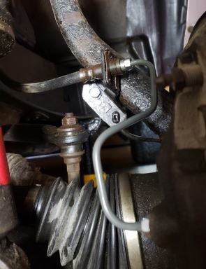

    A new day and a new brake hardline and ole bracket installed. Bleed brakes next task. Need 2 pickup a Venti+ sized bottle of Dot 3

    After a not so recommended Brake Bleed process (involved using two 2x4s and placing one at front of driver seat and the other applying force on brake pedal after a few pumps) the Ole T4R is On the Road Again. Will do one more Bleed with a helper tomorrow.
