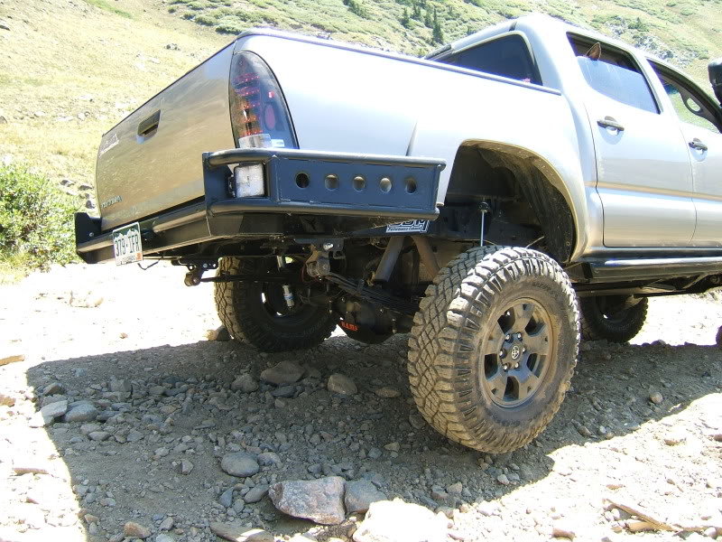

    My EXPOS are nearly level with the weight I have in back(about 350lbs of extra weight everyday). Most of their lift simply comes from the 11 leaves in the pack. I am at 4"s of lift in the rear with the EXPOS and a shackle flip with an extended length shackle. with factory bumps on and longer Blistein Shocks I see some N A.
    But I do like the droop:

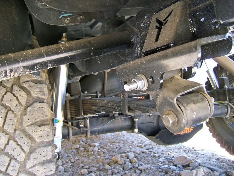

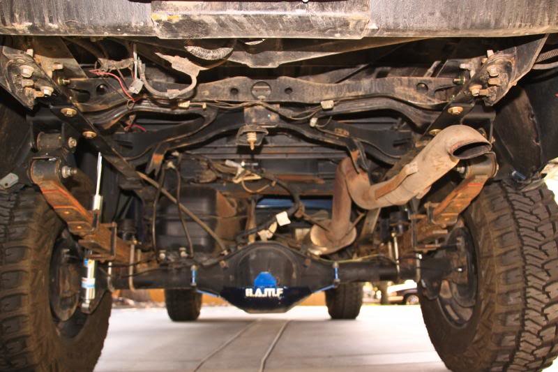

    dakar is the leaf pack that comes with most OME lifts
    flat at ride height? mine is arched a bit still but definitely not a large arch...
    you can kind of see the "arch" here,
    after the shackle flip

    Yeah the Shackle flip definitely "pushes" on the arch some. So if Redline is flat at ride height and no flip I would say they are worn. Unless you are leaving like 500lbs. in the bed all the time.

    Mine look real close to your first pic. I dont have the shackle flip. Would that lift the rear any? I dont ever put anything over 400lbs in the bed.
