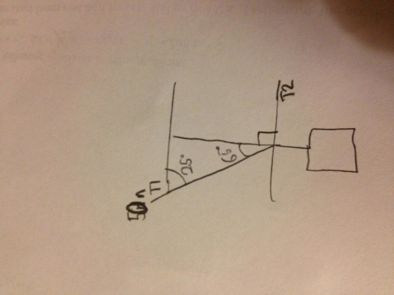

    I love physics and I teach science. What do you need checked on?

    Reworked the problem and t2 has 14N of force

    So are you confident that's it? I guess I'm not seeing where the rest of the info for that diagram is. What is the mass or force of that box hanging down?

    Magnitude of T1 is 50N
    Trying to find magnitude of T2
    I got 14 N

    I got 45.32N but I could be rusty. The system is in equilibrium (it's not moving) and so you are looking for the x component of the 50N force, which is the side opposite of the 65 degree angle. So sin(65)=opp/50.
    Sin(65)=.906
    .906=opp/50
    .906(50)=45.32
    ??? Does that look right or am I making a mistake

    If you draw it more accurately, I think that answer makes sense. Your 65 degree angle looks more like 20 degrees. So T1 would be much closer to horizontal. You probably moved on from that problem but I feel compelled to help if someone asks for it, especially with physics. LMK if you need anything else

    I have no idea if your right or not. I'm not even in the class but they said it looks right to them. It's one of those drawings that's half assed drawn so you have to look at the numbers closely. I was doing percentages of load based on their angles.

    I didn't do the math but this would seem right. (probablly should be studying for statics) Just sum of the forces in the X and Y.
