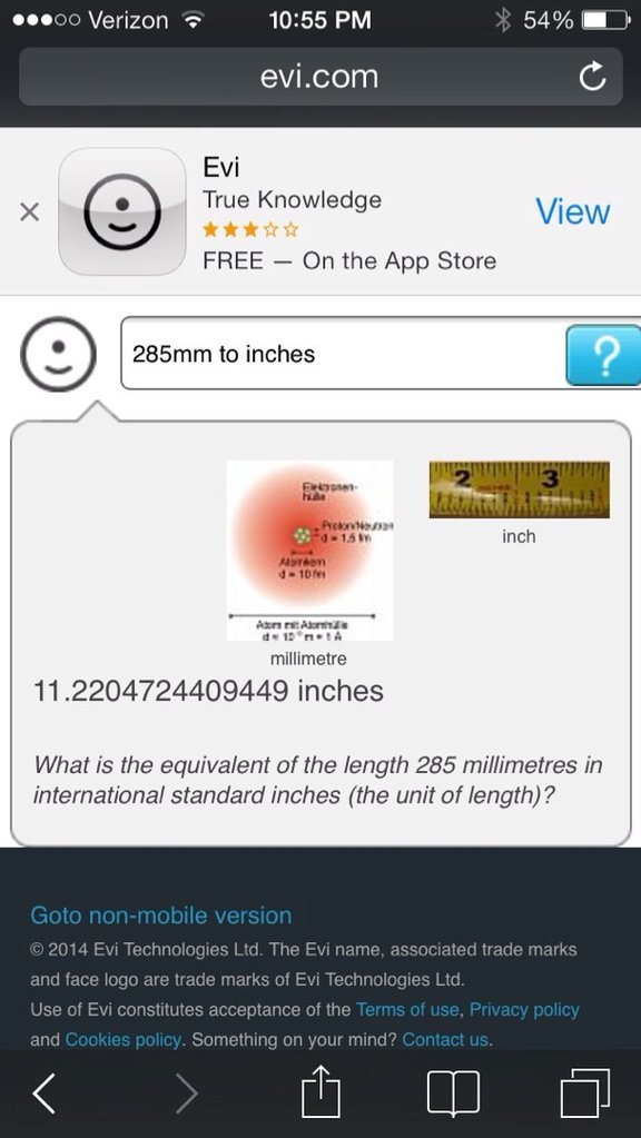

    No its not. Not unless you want 32.8 inch wide tires. If you convert 285 from metric to inches you get 32.8 inches.

    That's 285mm, of which, there are 25.4 to an inch. So I'm getting 11.2 inches, which is the width of the tire.
    The second number is the aspect ratio

    285 is the width of the tire in mm. The second number is a percentage of the width that gives you the sidewall height in mm. The third number is the wheel diameter in inches.

    Then the 285 must be from the rim to the edge of the tire, cause according to the conversion thing 285 is equivalent to a 32.8 inch tire and the 75 is equal to 11.22 in width.

    Ok I don't know what the fuck is going on with this damn convert thing. I need to find a different one, this one has given me 3 different answers for the same damn numbers and now I don't know what the right one is.
