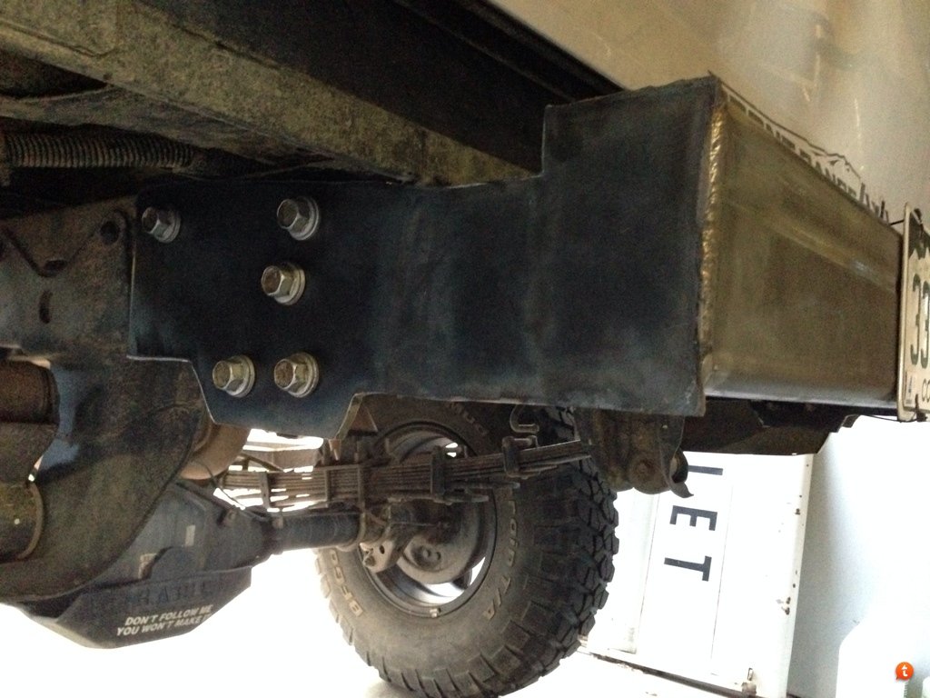

    It's going to wrap around and come up to each fender well. Increased functionality would be about 30 less pounds.

    I am just guessing on the clearance but I think with the simpler design, it will add between 6-7 inches and 4-5 with the fancier design.

    I never measured for that before. I think
    I should gain some due to a shallower bumper front-to-back. But not much cuz my short ass needs to be able to stand there to wash the topper, and to give the swing arm something to rest on.
    I used all 10 factory bolts for my brackets. Not going anywhere.

    Doesn't look like it to me. That looks strong as hell. Good job.

    That is stout.
    Nice job.

    Thanks! Needs some serious grinding. We were using 6011 for deep penetration but that shit comes out ugly.

    why 6011 you running 120v? but good choice for penetration... you could just grind them down smooth and then go over it with 7018 for a pretty weld... like a cap pass... but honestly it'd be a waste of rod. 6010/6018 is hard to get looking pretty especially going uphill or over head... not impossible... just difficult. and will never look as pretty as 7018.
