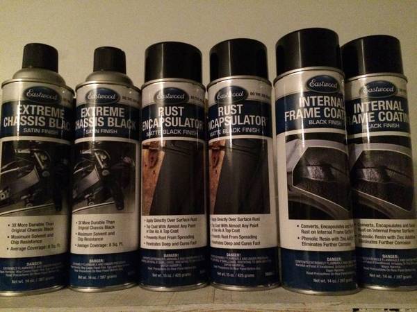

    Got this in today. Planning of giving this paint a try. Never used it. Going to start on my frame work this winter. Going to be doing a lot of welding.

    I'm interested to know how well the internal frame coating works and how easy it is to apply.

    It comes with a hose and fine mist nozzle. That is used to run inside the frame. I've seen Tim with the white 1st gen use it. It was pretty cool.

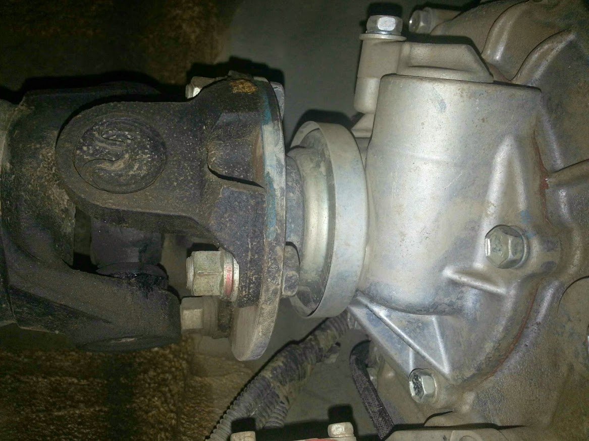

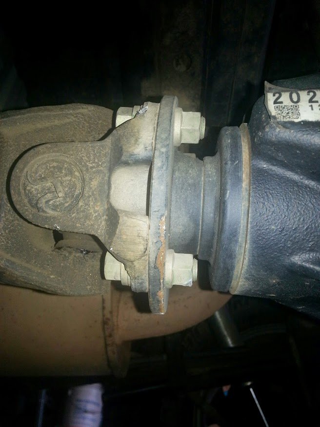

    Just happened to be under my truck removing the skids....
    Disconnect the bolts from this flange in the front
    This one in the rear
    drop carrier bearing in the middle
    just mark one bolt and it's location on each flange.
    no fluids should be involved.

    :D was I at least right? I haven't taken the driveshaft on this truck out, but that's the way I'd go about it if I had to.
    I suppose you could take apart a ujoint where the two pieces of the shaft connect and leave the front half in, but that seems like a pain in the butt and I don't know how smart it would be to drive around with the front half still attached.
