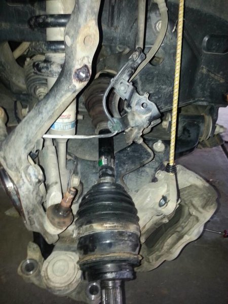

    Stupid axle doesn't want to just fall out for me.

    Knock it or pry it out from the back. Need a first gen owner to come help?

    You try a pickle fork?

    Holy crap! I was just about to set fire to the truck when it finally came out.
    Wouldn't that have to be one hell of a big pickle fork Lauren?

    Should of text me. Just need a large pry bar and it pops right out.

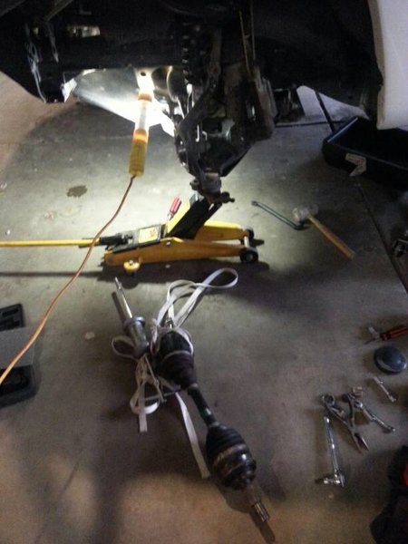

    ok. bushing is in and now I can't seem to get the axle back in.
    There's a ring type c-clip on the end of the axle. Can I take that out to make putting the axle in easier or does it have to be there so that the axle doesn't fall out?

    To answer all the questions, I replaced the pos needle bearing in the diff with the ECGS bushing.
    Hell, even hammering in the new bushing was kicking my ass.
    I ended up using my air chisel to hammer it home. No, I didn't go past flush with the outside of the diff.

    C clip must stay on. Use a dead blow hammer to pop it in.

    That's exactly what I did Eric. Except for the pop right out part.
    It required much cursing and banging. The dog and the kids won't come anywhere near me right now :D

    you hammer on the third part of this large, floppy assembly? That'll be a good trick.

    X2, c-clip is what holds in it. If you're going to hammer it, thread the nut on first so you don't screw up the threads.

    Well that c-clip sure did a hell of a job holding it in.

    I don't get it Eric. It takes a fair bit of effort just to compress the boots and everything so that the three parts of the cv are all together. To do that, and then try and hammer on the end of it....
    Is this normally a two person job?

    Left you a VM. Give me a call. I think you can take long screw driver and hit the corners of the fixed part of the inner axle. Trying to do this from memory at the moment.
