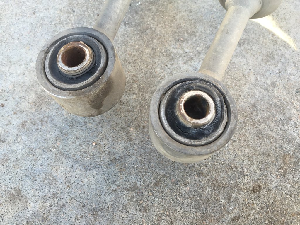

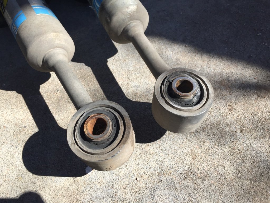

    Well put anti seize on the lower shock bolts, removed the IFS skid, removed the diff drop, test drove again and quiet as can be!! So stoked, time to put the IFS skid back on and call it a day.
    I am gonna say these bushings were the noise though, cracked and rusty
