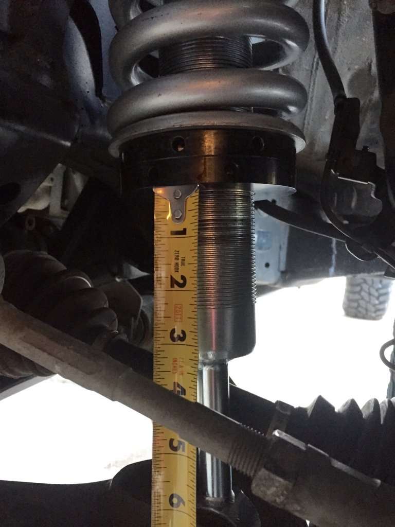

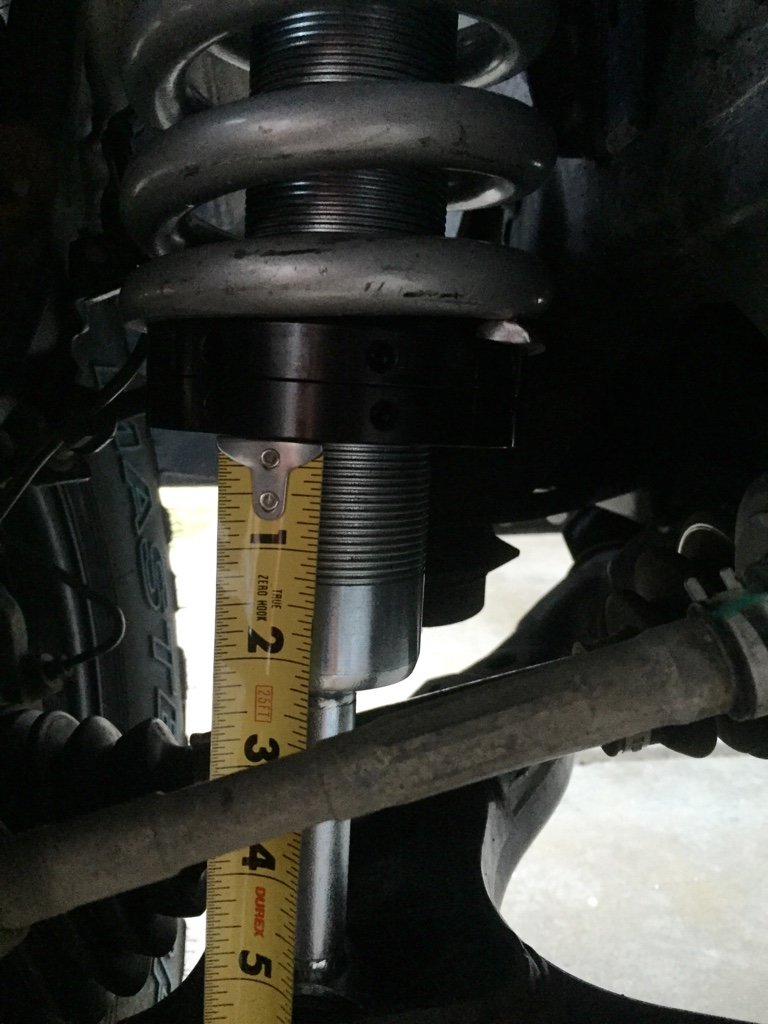

    2 1/4 showing on the left
    1 1/4 showing on the right
    Seems odd though that I wouldnt be able to get the BOSS kit back to where I was with the 5100 kit set at .85 though right?

  2. Mar 10, 2015 at 6:48 AM
    teamhypoxia
    teamhypoxia MichelinMan
    Aug 21, 2012
    #85247
    9,713
    Colorado
    '12 DCSB TRD OR
    Different springs?

    What I mean is, different springs on the billys than the BOSS kit?
    What springs did you have on your bilsteins at .85?
    How do they compare to the springs that come on the BOSS coilovers?
    That could make all the difference in the world.

    The shock body is a completely different set up then your billies. And what Eric says is right. If the spring is different then it might have a different spring rate. That being said I thought Toytec was using the same springs on the billy set up and the BOSS set up. So this should not be a varible. And the Springs are new right? So you should be able crank even less. Mine have settled now and I need to crank them a bit more.
    Call Doug and ask. When I was there with my warranty replacement he told me not to go over 2"s of exposed thread to maintain proper operation of the shock. I have the 650lb red shocks though.

    i wanna say that both my spring rates were 600lb, 600 is in the new BOSS coil numbers and 620 is on the old 5100 coil numbers.
    Ive got a message into doug already, they also told me that the new BOSS system has a bunch of threads above where you should be using so i just want to get a definitive answer from him if im ok having them set a 1/4 inch to high or not.

    truck is sitting at work now so no big rush, ill be adjusting again tonight and probably just lower the drivers side to hit 2" of thread showing and then lower the passenger to match, I'm an inch different side to side, is that what your showing eric?
