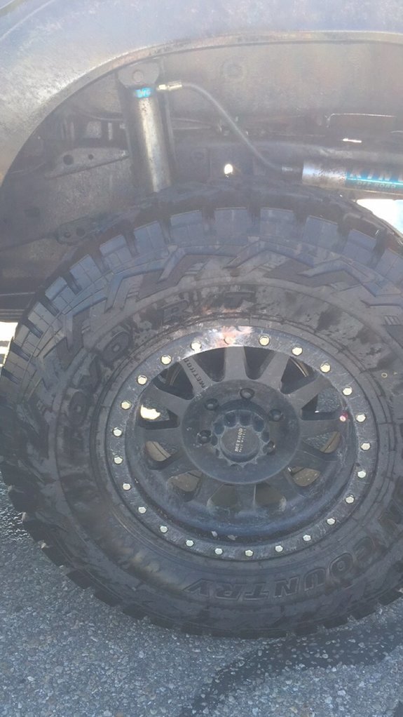

    And yeah when you look at the truck/wheel it doesnt appear like anything is wrong, but like I said, its different in person and driving it before/during/after the incident.
    Curious to see what someone who knows their shit says about it.

    Noah where is the pic at?

    This is the one I posted I think. Can't see much

    Is that an alloy wheel?

    Well from my phone it doesn't look bad. I believe you though. Fingers crossed for you.

    I really hope I'm wrong but you may have bent the axle shaft. I've not ever seen an aluminum alloy wheel bend. I've bent the shit out of several steel wheels though.
    Fingers crossed it's just a fubar wheel though.

    Yeah I may have fucked somethin up bad, thats why I'm taking it to the one and only TOYOTA GOD
    Its an alloy I think

    It'd be real quick and easy to swap the rear wheels and see if the wobble goes with the wheel or stays at the same end of the axle.

    I could do that but I don't have a tire balancing and mounting machine. Or a lift
