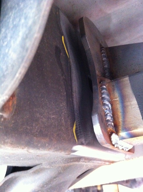

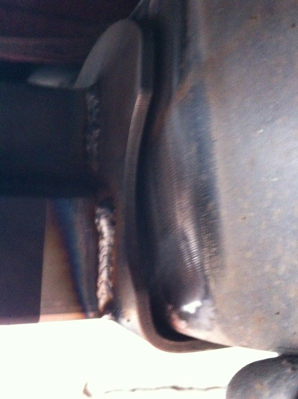

    Hey Chenbro, about the powder coat, I don't know if it's the same as Eric's but when I went to weld a tab on Eric's LCA skids the so called powder coat melted like rubber and didn't burn like paint on the back side of my weld. I never seen that before. But who knows what Bamf used to coat it. It didn't seem like powder coat. Maybe someone that knows more about it can educate me on it.

    were the L brackets already welded to the legs or did they come separate?
    If they were separate then that explains it. you had a better fabricator weld them to your truck.
    Mine were bolt on. After installation and discovering the issue with the door, it was obvious that the legs on one side were welded much higher on their bracket.
    The LCA skids I have were hitting and bending up my frame. When I pulled them off last weekend, I think I discovered the problem. There is a 1/2" shim at one of the bolt holes on the passenger side (wasn't hitting) that wasn't present on the driver's side (was hitting).
    I'll give you that the sliders are stout. God knows mine have seen a lot of rocks, taken some good hits, and have definitely prevented damage to my truck which is what their supposed to do so that's good. But that is mostly a function of the material. It's the QC of the fab work that I have an issue with. I don't think that after paying to have something fabbed, you should have to come up with janky fixes and workarounds to actually use the product. Customer service is another issue. Pelfreybilt and RCI are a couple of companies that I've dealt with that have that aspect nailed. BAMF could stand to work on it a bit IMO

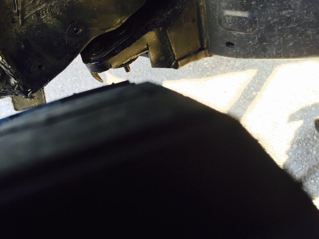

    what are you going to do with that hole? fill it with plate once cutting it back further, or are you going to get a smaller body mount and trim back further and then re weld on a plate for strength?

    Ideally I am going to get it plated in, again.
    I can finally hairpin with no rubbing though. Going to need to take it on an easy trail here to see what else needs to be clearanced while stuffed
