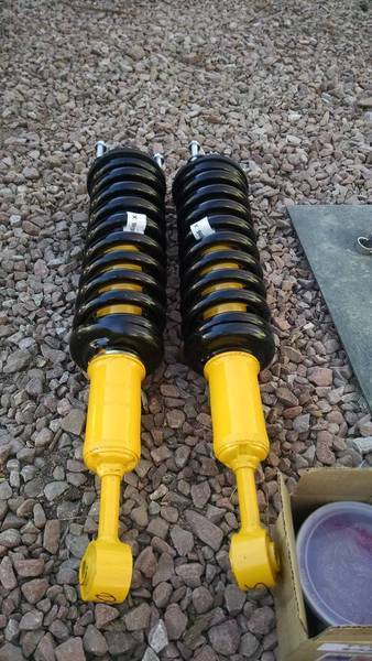

    Lifting my buddy's 06 DC today. Still on the fence about the rear leafs and their "which side?" markings.
    To recap, the - mark should be passenger side.
    the () mark should be driver side.
    But my friend sent this pic to Toytec. Which was a mistake imo, he should have simply asked, which spec spring is for driver. Instead Toytec shot back, "the taller one goes on driver side", after being told the taller one was the - spec pack....
    I guess I have a 50/50 chance that I may be removing the rears and swapping sides. I would like to see actual facts on these things. :rolleyes:
    Now imo, after re-arching packs for the last 20 years, that slight 3/16" raise is inconsequential, could be simply an extra bit on the main leaf. So I'm going to place them as TW members have recommended, with - on passenger and () on driver.

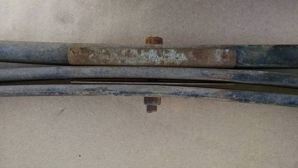

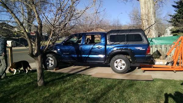

    Troy's 2006. Before.
    886
    Pederson fail. These were the original springs. Long story, but they had an AAL, and Pederson wouldn't sell the truck with it in there so they removed it.
    They didn't bother to replace the center pin and also didn't bother to tighten it. Both side were like that.

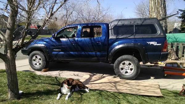

    New Dakars with a 4° shim. The () springs are on the Driver side, the - pack on the passenger side, sits level.:cool:
    Completed rear.
    Perfect pinion angle.
    A few more glamour shots coming...

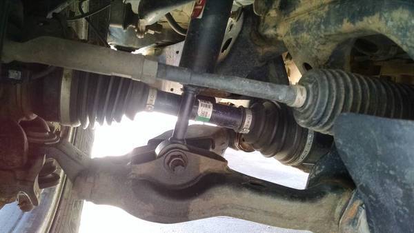

    Front CV before.
    After.

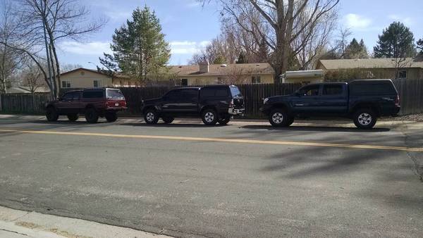

    My stunning '96 1st gen, My younger brother's 2012, Troy's 2006.
    The 2012 has 884's with a top spacer and the AAL in the rear. Stock bumpers aside from the brush guard
    2006 has 886's, no spacer, with the Dakar pack. ARB bumper and a 9K winch.
    Hard to see with the glare, the 06 looks a little taller, could be the flairs. Both trucks are running 265/75-16.
    Hope you guys don't mind me posting all this, I figure truck pics are always fun to look at.
