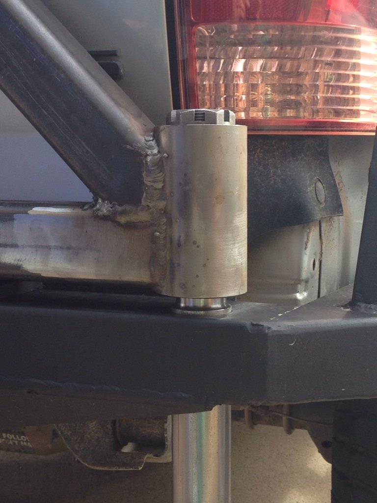

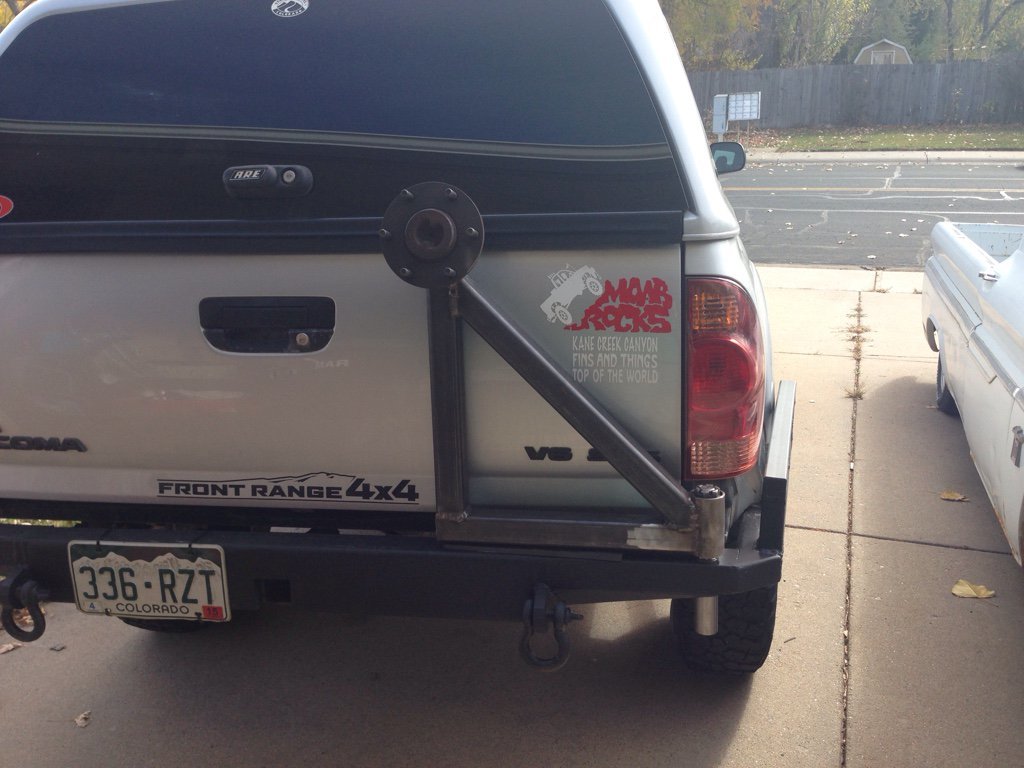

    I posted this in Joeys build too but wanted some advice. I am trying to find a good closure latch to finish my swingout bumper finally.
    Here are pics of where I am:
    What do you think about this style?
    http://www.amazon.com/-Sta-Co-Strai...&qid=1431183605&sr=1-2&keywords=de-sta-co+630
    Because of my design, I think that I could easily drill a hole in a thick (around 1" thick) plate and weld it to the top of my bumper and mount this clamp on the swingarm itself and when it is closed the plunger pushes into the hole and locks it in. Could probably find a polyurethane bushing to go into the hole to reduce vibration too. I have just never seen anyone use one like this.

    I don't think you'll like it Travis. I think for offroading you're going to want something that clamps stuff together tightly.
    This looks like just a plunger in a hole? Nothing to stop up and down motion.
    Might wear out your spindle quickly too.

    The plate would Also be a rest for the arm to avoid wear on the spindle. I see what you are saying but my design has somewhat limited what options I have.
    I have thought about something like that but I would Try to find a threaded piece that had a handle so that it didn't require tools. Not so sure the wife would be okay with something like that just because she wants ease-of-use. Unfortunately her Input has to be taken into account on this.
    Good points made, might just have to keep
    Looking

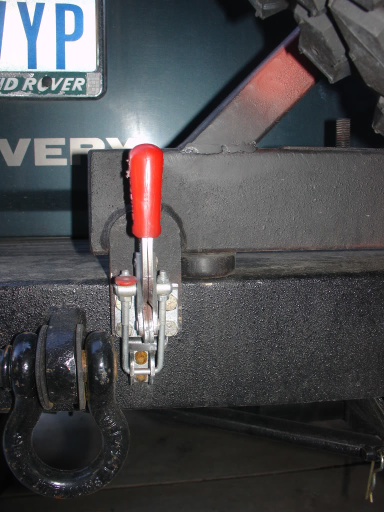

    Maybe this way..
