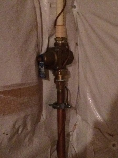

    My pressure regulator effects my sprinklers as well. As the outside line t's off in my basement after the pressure regulator.

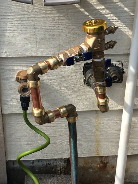

    Yes, there are a lot of elbow pieces on there. I just said screw it, and grabbed some sharkbites

    Lol!! Sean that's the funniest looking back flow job. But it works lol. You know Chris's brother could have sweat those pipe joint in a few seconds lol.

    You hooked your back flow preventer up to a wall hydrant?
    I honestly can't say I've ever seen that done before.
    Did you have water hammer (a single bang when a valve closed) or was the back flow preventer continously chattering while the sprinklers were running?
    If it was the latter, I'm wondering if the anti siphon on the hydrant affects the back flow preventer somehow (it's kind of redundant to have both)
  11. Aug 10, 2015 at 9:40 PM
    T-Rex266
    T-Rex266 SpaceX Director Moderator
    Mar 21, 2011
    #53447
    28,259
    Elon
    No. The backflow was already hooked up like that so we just swapped it for a new one and added shark-bites.
    It would chatter during sprinklers or any faucet from the upstairs master bath.
    Nope. I reached out to him, he don't know what the original issue was so my neighbor and I did it based off his experience.
    The valve has a small leak so we couldn't solder any unions to it, no matter how much heat we took to it - so we got the shark-bites instead.

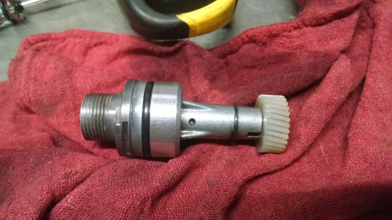

    A side pic for our resident plumber :D
    Re-last night's side discussion.
    TH350 speedo gears, same diameter, varying tooth count. These gears all fit the same GM transmission and give you different speedo readings. And they are very close to being the same diameter, if not actually the same. The pitch and cut of the gears I think is how they get away with it.

    Just based on what you're describing Sean, I think I know what your problem is/was.
    Here's a cutaway view of your backflow preventer
    You need to have enough water pressure to overcome the springs on the diaphragm so that when it's turned on, there will be a good seal on top of the poppet.
    Two things can mess this up. Too low water pressure or a bad seal. Either one will cause that "chattering" you experienced as the seal bounces off the top.
    Your pressure regulator lowers your water pressure. Turning on another fixture (like the shower) temporarily lowers the water pressure.
    Your backflow is connected to a commercial wall hydrant (hose bib, sill cock, spigot, pick your term) How the hell that thing ended up in your house and why the sprinklers are connected to it is beyond me, but it has an anti-siphon valve in it and it is further reducing your pressure.
