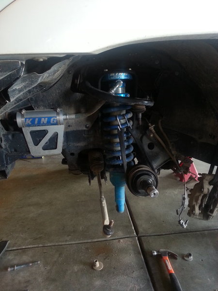

    Figured I'd check out the other side since I had all the tools out and everything.
    Started turning bolts and stuff and before I knew it, everything had fallen apart. 1441491292657.jpg

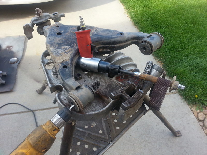

    Pro tip:
    3/8 extention and an air chisel drifted the front cam sleeve out nicely.
    To clean everything up, I stuck some copper fitting brushes in my drill. 1/2 for the rear 3/4 for the front. A little sand cloth cleans up the bolts and sleeve nicely too

    @thefatkid you might be pleased to know that I couldn't budge the jam nut on the drivers side tie rod without a torch either.
    Fortunately, I was working with better tools than we were roadside.
    How does that even happen? Do i need to tell the alignment guy to chill?

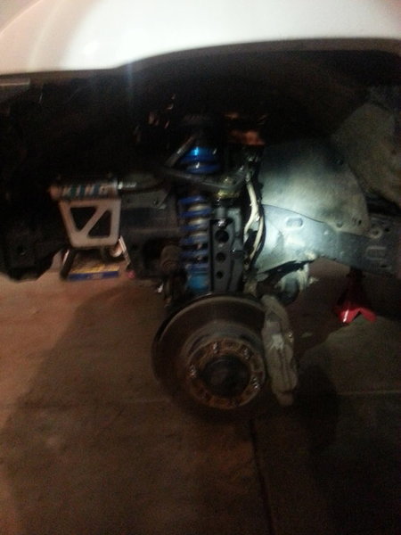

    Definitely looks like some negative camber.
    I'll try to do a half ass alignment tomorrow

    See I don't get that unless something has changed between your year and '12.
    The passenger side came out pretty easy with just a light bend on the inner fender. I did flip it around when I reinstalled it, but I could've put it back in the same way just as easily.
    The driver side, on the other hand was a bitch. I think because of the battery box or something. I ended up putting a long jack handle down in there and whacking it with a mallet to get enough clearance to get the bolt out. When I tried to flip that one, however, it wasn't happening. There are 4? or so brake? lines plumbed right where the bolt would need to go to slide it in. I ended up putting that one back in the same way it came out.
