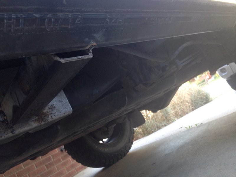

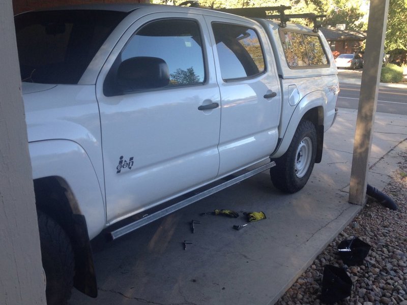

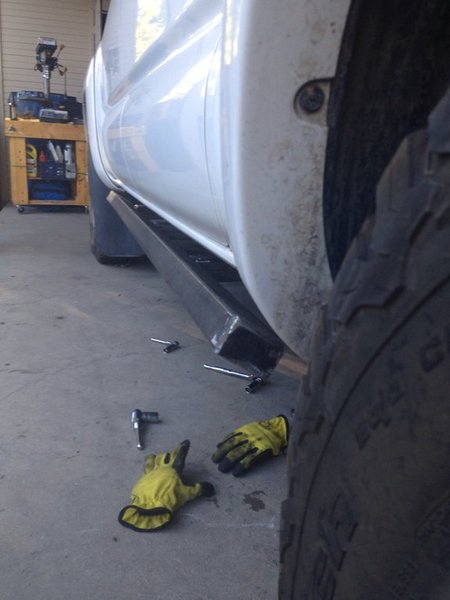

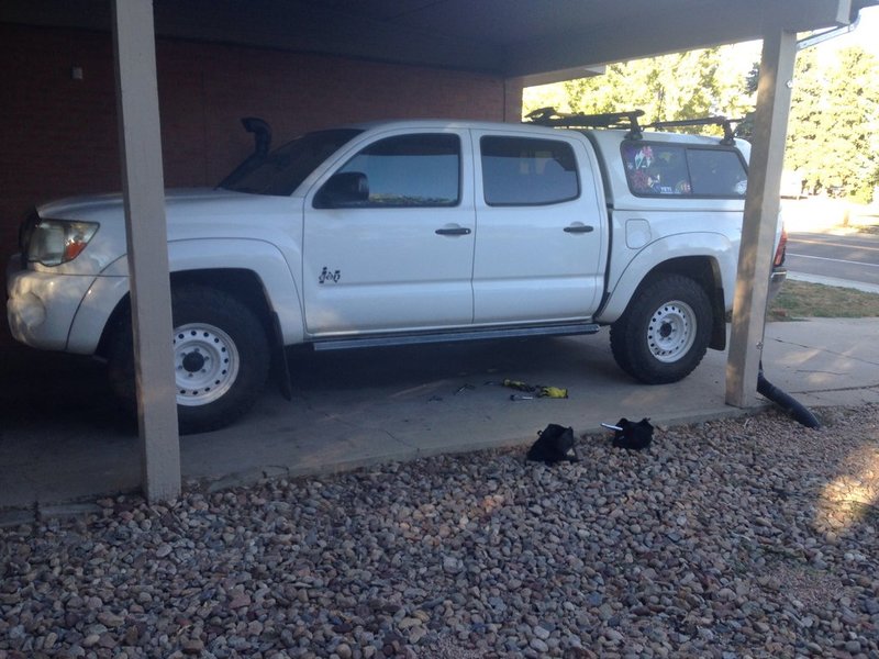

    Looks good to me before I completely weld them.

    Looks like it

    Not much space past that for mounting a leg with the bolt on plates. I've run 3 legs before on previous tacomas that were heavily abused and didn't have any real problems.

    OK. I am sure they will be strong enough but I was just curious. My Slee Sliders have 4 legs and utilize a sub frame design like you created there. I do like how yours are nicely tucked. I am really digging your color matched steel rims.

    Are you going to add some filler plates to those those gaps? Gussets never hurt either.

    Yep, going to add fill plates and gussets. Still have only mocked up the drivers side.

    Sweet, excited to see what you come up with. I have a set of bolt on Shrockworks that were bolted on, but the mounting points were bending so I cut them off and welded them on.
