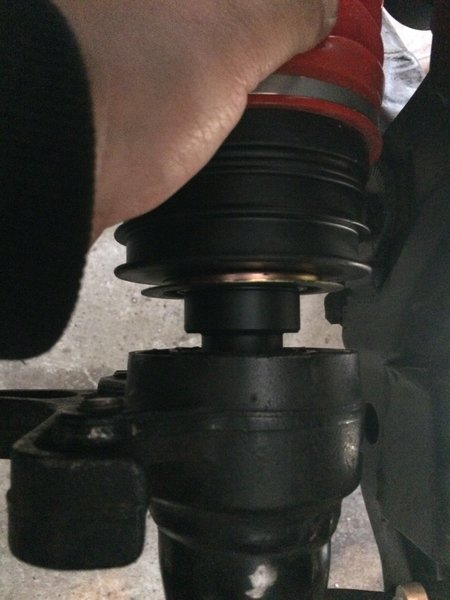

    So I just jam this bitch in there? Never done it.

    Yes, just try to keep it from dragging on the seal when your putting it in, wiggle it around while you put it in to make sure the splines line up and push it in. Sometimes it snaps in easier than others. Make sure you hear/feel the click of it snapping in completely.

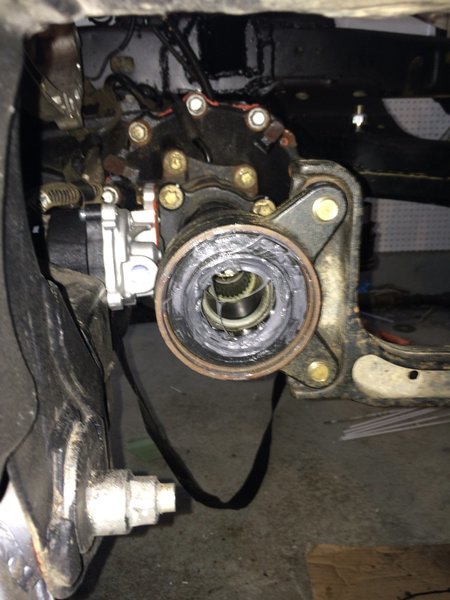

    I can only get it in this far and it jams up. Passenger side

    Do first gens have the little c clip that needs to be installed with the opening down?

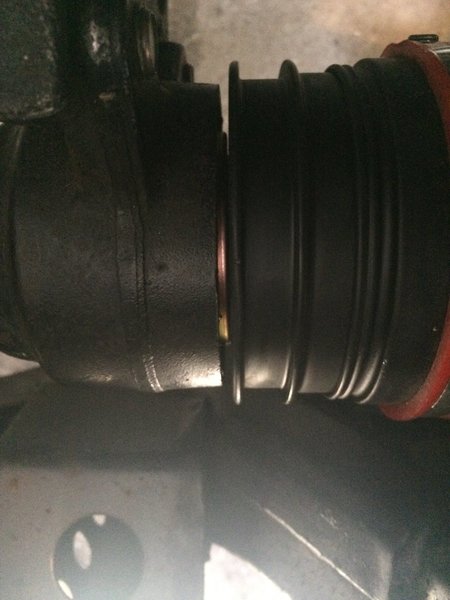

    Whacked it with the rubber mallet. Didn't hear a snap but it looks like I got it in. What you guys think.

    I'd say that should be good, it wont usually go flush. Try pulling on it and make sure its seated. Only pull on the inner most section. :)

    Looks like you got it Ray! I always try to position the C clip so the opening is down and also coat the splines in gear oil.
    Avoid hitting it with a metal hammer. Destroys the threads every time. Ask me how I know.
