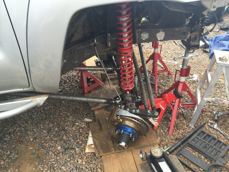

    It should not bind at all. Not that much angle there and i know that a drive shaft of normal u joints would work but if not i can get misaligned hi angle u jionts to run.

    I think it should be just fine also because its a high pinion and not a low pinion.

    as an example only...
    I went with a simple leaf spring, soa. (spring over axle) on that Scout.
    Should have been a slam dunk right? just a simple lift with virtually the same components.
    Nope.
    Had to cut and rotate the outer "C's" 15 degrees to get the pinion angle up and maintain some kind of castor. 4 degrees of castor and 11 degrees of pinion angle is what I ended up with.
    In the end to alleviate bind I had to go with a double cardon shaft to keep the shaft from binding at full droop.
    That's only part of the problem too. You also need a long enough slip joint in your shaft. Much longer than the rear.
