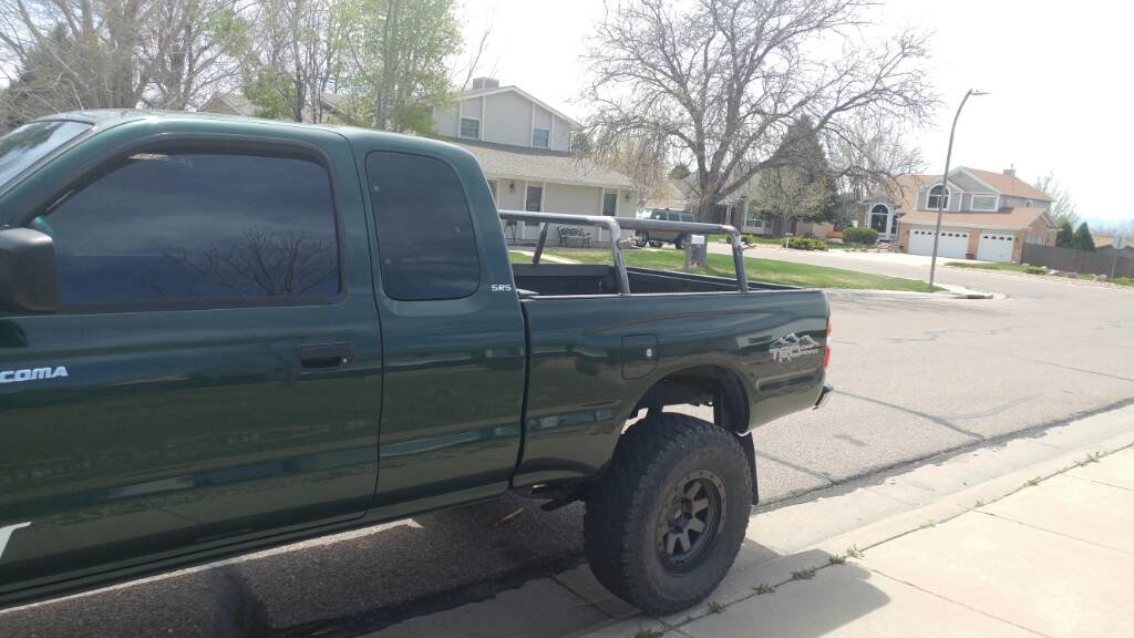

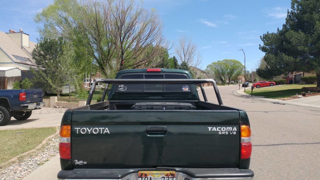

    Anybody know if insain makes cb mounts? They're not the best at replying, so I might just order one from BAMF.

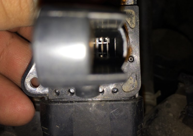

    You SOB. I was truing to distract ppl with my PCV.... Quoted from the 1st gen section. I just didn't post it here.:notsure:
    An update on the code p0172. Running too rich. My MAF was dirty. When I cleaned it the first time I really didn't clean it right. When you remove the MAF to clean it. In the upper portion of the sensor there are two hidden wires that also need to be sprayed cleaned. Figure I share my failer so it could help someone else out.

    No, 3rd. Just wanted to get a bed rail mount.

    Where does it mount?

    Please go on. I tried cleaning my maf and curious what you did.

    It will easier if I get some pics of the area. Give me about 15mins or so. I'll get you some.

    The way Brain explained it to me is that the wire with the ball is for temperature and up inside with the two wires is for volume of air.
