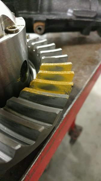

    Almost exactly where I built this one at.

    SWEET!!! That makes me happy. Now all i have to do it put u jionts in the shafts tomorrow and start the process of braking things in!! Ray i hope your still up for driving.

    Yup. Make sure you take care of the heated and cooling of the diff prior. Sunday is going to be putting miles on it. Not sitting for an hr waiting for it to cool.

    @thefatkid that is just the 3heat break in cycles right?

    Yes, make sure you don't just drive through the 500 miles though. You still need breaks with cool down. Get a laser temp gun. Keep temps below 190°

    There is quite a bit of breaks in between because of paved roads. I wouldn't go over 50mph and for no longer the 50miles at a time. Then drive 10 miles in 2wd. I didn't have a heat gauge. But we will keep it under 190* for sure.

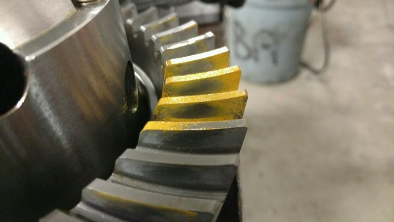

    .002" shift in pinion. Looks better.

    Thats the thing i hated about the set p kits is out of all three kits my pinion depth could only be changed in .008 increments...:annoyed:

    It comes down to a lot of math and shim selection. Also, I have a billion shims now.
