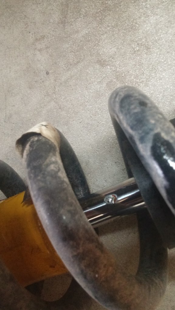

    Thanks again for the garage time!
    Shocks were swapped out, it appears that the shock extender preventer doohickey that used to be tacked to the shaft at some point became unattached, the leftover spot welds were tearing up the shock seals.
    So the old shocks both had the long travel mod as you can see in the side by side picture.
    There were 4 of these little spots where the alleged limiter doohickey used to be at.

    Seems like a poor design...

    Your welcome! Let me know when they break again in a couple months.

    Different diameter lower rod is interesting. How long have you had your old ones?
    TimF: "They're all Monroe's with a different color paint."

    Installed last June i think.. Old ones have Feb 2015 date on them, new ones are December 15 iirc.
