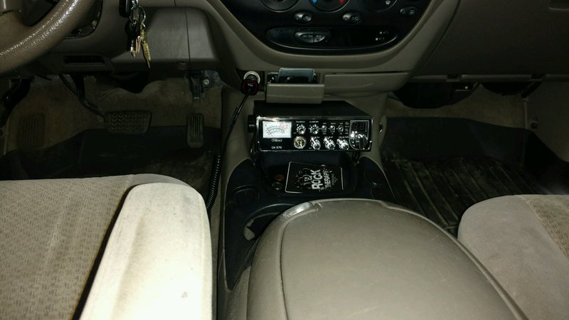

    I know. I stopped by groove and asked @thefatkid about it. I could still upload some so you guys can have some input.

    If @thefatkid vetted the mount, then it could be that the antenna is too close to the roof of the cab. When we were tuning @RockyMtnTRD 's radio, the SWR was off the charts until we moved the antenna to the back of the bed.
    I also started out with a Wilson 4' whip, but no amount of shortening the antenna would give me a good tune. I removed the tuning tip, tried attaching that ground cable, attached the antenna directly to the mount, but nothing would get me a good SWR (even though the SWR did move down a little with each thing I tried). Eventually I just gave up and got a 3' antenna.

    Looked like he has some grounding issues to start out. Once a little more paint is removed another test will need to be done.

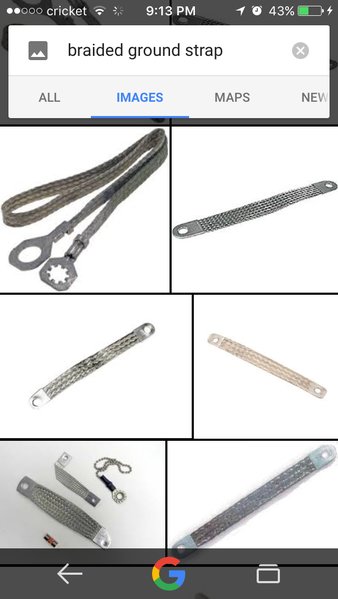

    Could you ground with a braided strap

    Forgive my ignorance but why would you have trouble tuning an antenna if it's mounted same height as the cab?
    And what's a braided strap?

    The more antenna above the cab the better. If it's level or below the cab then it becomes a problem. The cab effectively blocks the signal. Location has a great deal to do with CB antenna mounting on a vehicle. Top of the roof dead center is the best but not always practical.
    Just a ground strap
    CO MTN Steve likes this.

    I have two of these. One to the hood and one to the engine compartment.
