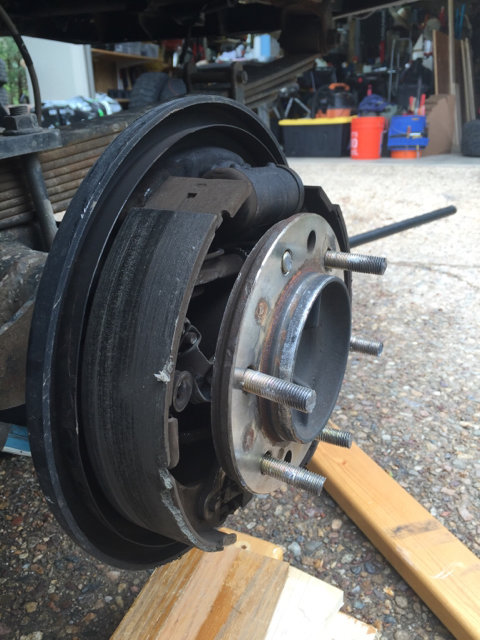

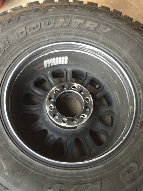

    @RockyMtnTRD , do you have any pics of the wheel itself, from the lug side? Any visible damage?
    I'm curious what kind of impact was needed to do that kind of damage.

    079751193eb2ae17210a9707eef9a17d_f30d2015e33ffe38851b65c8dbada3822df855e3.jpgb08c8b6da1d7007f1a8027d706be7f7c_60ac51317a5b3c9d70b99009fef22e8bf233cfa9.jpg
    Lugs still in... Gonna need a new spacer lol

    Scuff is on the left side there, tried to clean it up to see closer up the damage

    That's crazy man. Did the spacer just shear off the axle flange?

    Appears that way... And this whole assy is fucked. f4d1db741bb4056955dbb56af2944e2e_aa7bab87a74e200fc06f03fdb1e0845b744b845e.jpg

    Almost looks like the spacer bolts came loose. Are the nuts for the spacer bolts still trapped between the spacer and the wheel?

    Looks like it might be able to be saved without too much headache though. If the wheel brake cylinder and the bearing/seals weren't damaged, install a new spacer, new set of shoes and torque it all down.

    Hard to tell cause all the studs sheared off. I did install these wheel spacers not long ago, but I torqued them down after a week. Shouldn't have come loose but fuck who knows

    Think it may be more than that unfortunately
