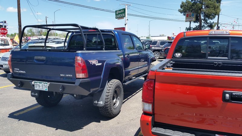

    Hmmm who was hanging out at Edwards meat market on Saturday.... :spy:
