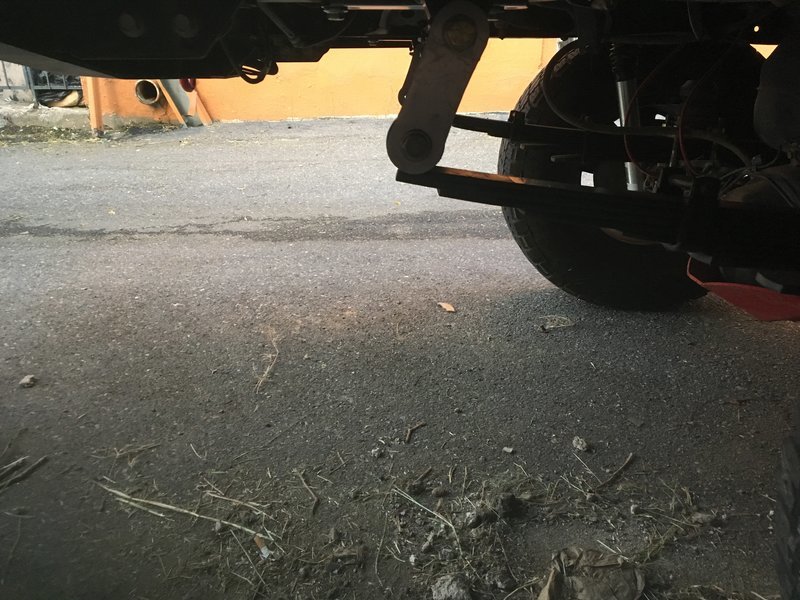

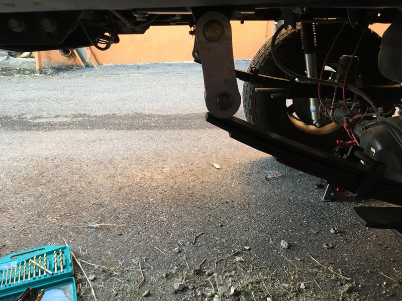

    Thanks for all this great info @Gramps! For now I'm planning to add a spacer to the bump stop strike plate on the frame to bring it an inch closer to the bump stop.
    Here's how it looks with the shackle in the foremost position. I think i want to either drill my own holes, or have it welded just a little further forward, to get my hanging angle closer to 90 and resting closer to 45. My back end is definitely higher than I'd like to be.

    If you have new springs, they'll settle and reduce the angle of your shackle, and the height of your rear. I like the angle of your shackle more than mine, my shackles are closer to 60* at ride height.

    I think the angle looks fine. Like BRT said, they will settle.

    Appreciate the feedback guys. I won't make any adjustments yet...it's just too good to be out from under the truck today and I'm eager to take it out and play. It was a hell of a lot of work but I'm really happy with the end results.

    Or you could shorten the shackle a bit but yeah your angle is a tad off.
    That is a good point about the springs settling. Yeah I saw your resting angle at Corey's and it looks like that shackle hanger needs to move back to the last hole to big thr angle up a bit.
