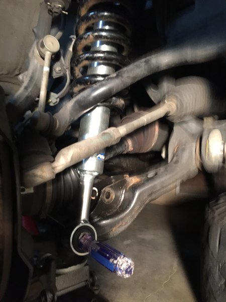

    Take you sway bar loose for one. From the pic it looks like it is still attached.

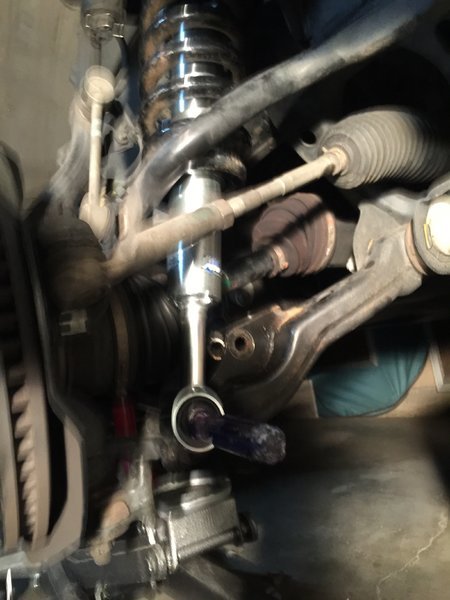

    image.jpg So I got it off now I'm trying to put the spring and shock back and the lower control arm won't budge I loosen the bolts and it won't fall to the ground like the other side it Springs back up in place I don't get it I guess I need a spring compressor I didn't want to half to use one but that dam control arm lower buy the way won't fall am I missing something I just did this to the other side so I thought I knew what I was doing ha ha

    It might help to unbolt the spindle from the upper control arm

    The lower control arm uses rubber bushings that have pre load on them. Have someone step on the lower arm and keep it under pressure and then use a pry bar to slide the coilover into place.
