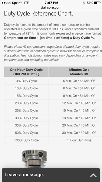

    Most with have a overload switch that will trip if it gets to hot. 100% Duty cycle does have a time limit on it. For instance 100% means you can run it for 60 minutes strait before it has to cool
    50% means 30 minutes running 30 cooling
    Viair has a chart for this.
