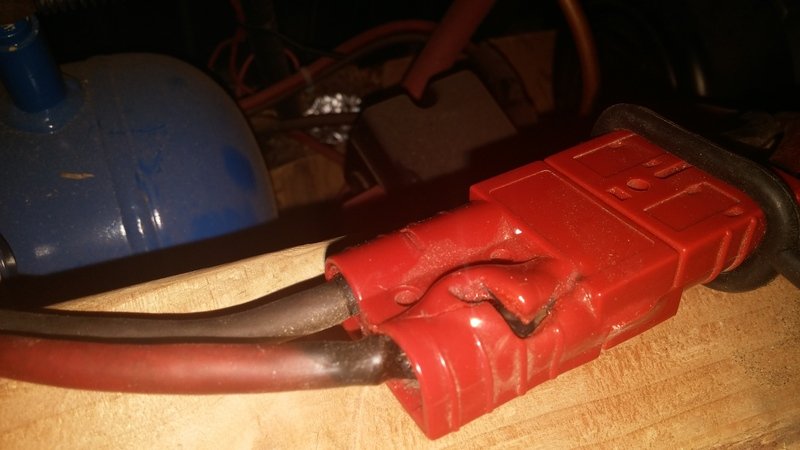

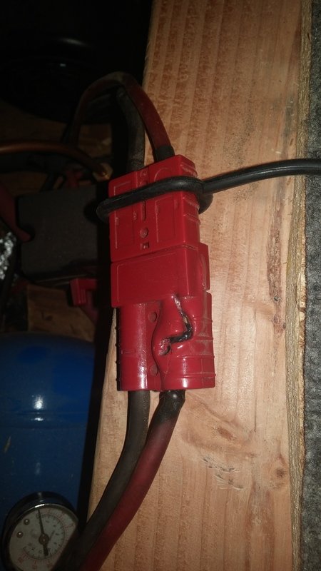

    Sounds like it wasent crimped tight, or not enough wire crimped to hold, a pull of two got it down to just a few strands of wire causing a choke point that when all the power whent through heated up. Being that it's where the wire met the connectors do not the connectors pin area it was not the plugs fault.

    I just want to make sure it's fixed properly... The quick disconnect isn't really needed, it was just on there from when i originally used it as a portable unit.
    Of course i have access now but it's not a bunch of room for soldering... Which is something i suck at.
    And when i did the wiring, i did the 3x rule on amperage and length of wire on a wire chart, so it should be good? Unless the wire itself isn't as good as it should be.

    Get splicing crimp lugs then.

    Just the regular looking tube ones? Can i get ones that are rated for this wire anywhere? I think it's 8 or 10awg'ish

    A and A trading post i know has them. You can try ace or something like that. Or order them off. Amazon and just dont use the compressor tell you get it fixed.

    Yeah, definitely won't be using it until it's fixed.

    Will something like this work? Then covered with a layer or two of shrink doohickey.
    http://m.lowes.com/pd/BURNDY-2-Count-Aluminum-Lugs/1000080263
