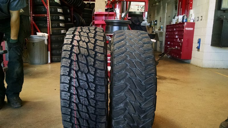

    You guys are All comparing diff sizes. Pic inbound to live

    285 next to a 295.
    Keep in mind the Toyo's are about 50% tread right now. So not really that much of a difference if both tires were new. The width is actually wider as well with the 295's.
    I really want to be narrower if possible.
    At full lock, the 295 rubbed the same as the 285 on the frame.
    So, wanting taller as well as narrower, the only real options are 17" wheels.
    Plus, I'm staying with the E rating. It's stiff, but the durability is phenomenal. The Nitto's in a D rating felt a bit thin.
    I have 17" x 8" 0mm offset wheels on the way. Steel. Wanted alloy, not available in a design I liked.
    Guess what? there aren't many options for that size either. Most are now 17" x 8.5" and the most common is 17" x 9" Both would set me closer to the UCA and might require a spacer, which I really want to avoid.
    negative offset is a unicorn for the most part except for the most hideous of wheels.
    Tire will be Cooper S/T Maxx 285/75R17.
    Forget the actual metric numbers, they don't mean shit to the manufacturer :)
    My Toyo's measured at a true 33" dia. x 12" sidewall x 11" tread width
    The Cooper's, according to the Cooper site, are 34.06" dia. x 11.1" sidewall and a tread width of 9.21.
    So taller and narrower.
    I have a bfh at the ready if needed.
