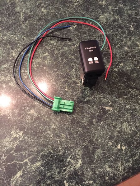

    So the iggy light switch has 3 wires red /black/ blue
    My switch has red/ black /green/ blue
    So it looks like the blue on iggy goes to relay ... according to my switch diagram green goes to relay
    So red to red black to black
    Blue to green????
    So I have extra wire on my switch
    Blue????
    Also the wires on my switch are a lot thinner than iggys can I crimp them together??? Any help guys
    New to this stuff..

    What switch? Got a pic? As for crimping you should be fine since using a relay

    Extra is for illuminating it

    Ok, so it looks like the mictuning ones I've had, red and green are the switch so red to red, green to iggy's blue.
    As for the other, check schematic, but prob black to dash power grround and the blue to dash light power. This way dimmer works

    When I wired my AOB switch green went to +12V source (location depends on if you want constant hot or keyed hot), red went to pin 85 on the relay, blue was tapped into the cabin lights to illuminate the switch, and black went to ground. Hope that helps!
