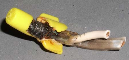

    And don't forget to use the self-soldering wirenuts :anonymous:

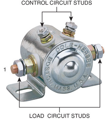

    So I can put them on either post...since there are no markings. Ground/12v from switch can be either small post, and incoming power/outgoing to compressor can be either large post.

    Yeah, should be able to use either end

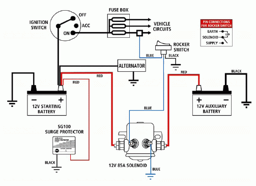

    Look at bottom picture.

    You can reverse them.
    Electromagnets do not care which side they are hit with the positive and negative (Unless it's a negative ground body, then it better be labeled) and current will flow through the large terminals either direction.
