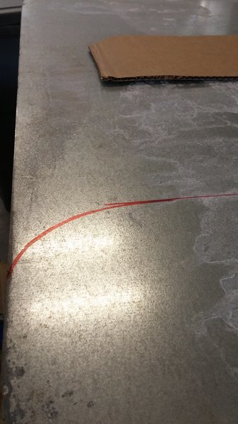

    Is there a way to tell if metal is galvanized?
    I got this at the metal yard today.... Making the air tank mount.
    The good news is... I'll only need to weld a tiny bit, and i have a respirator.

    Galvanized looks like this.

    Galvanized is usually shiny and will not rust.

    This has some rust on the corner....but it looks like there's a coating. :/
    I think respirator just in case. :)

    Dude, that's just straight up sheet metal. You really should learn to recognize on sight, it may save your life :)
    All right...lets get technical
    Galvanized coatings look like little flakes.
    https://www.google.com/search?q=gal...ved=0ahUKEwjnjcaO26vQAhVilVQKHTlOCzMQ_AUIBigB
    Then there is Galvaneal...this coating can look shiny or matte finish. Still deadly.
    https://www.google.com/search?q=gal...ved=0ahUKEwixrvnT3KvQAhVCh1QKHWaQAcsQ_AUIBigB
    Either way, nothing wrong with the respirator if you want to use it.

    Galvanized does rust, but it takes decades. generally, there is no rust as long as the coating is not compromised, scratched, removed, burned off from a welder, etc..

    That piece in your hand, is actually Hot Rolled steel, that's why it appears to have a coating. It's just leftover slag from the process. Perfectly safe. Burn that shit.

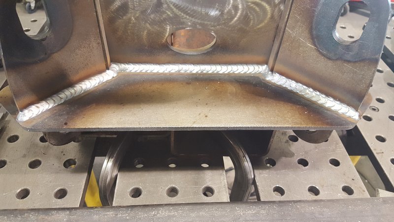

    There's also P&O (pickled and oiled) mild steel.
    From today . I haven't welded in a while, this is one continuous bead.
