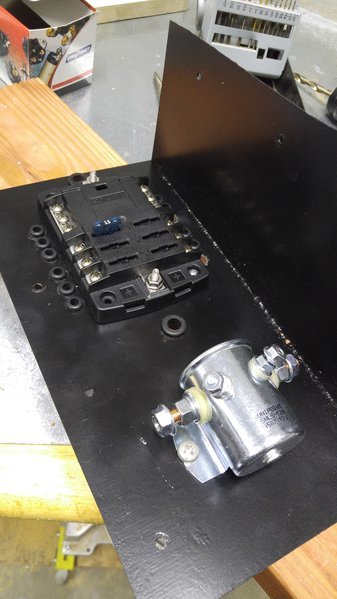

    Have to run the power/ground back to the bed, wire up compressor relay, water pump, bed lights and compressor switch wire...and that should wrap up the overhaul.

    Wire that solenoid's on off into an ignition power so when the truck is off that is off. They will drian and tank your battery if left on. Its very hard on the battery and i will say sol because the battety can not do that.

    So the trigger wire needs to be on an ignition powered circuit?
    Like the 12v source to the switch that then goes to the relay needs to be ignition on instead of always hot?

    Yes. The little studs. The hot to the little studs need to be to an ignition power so it shuts off with the truck.

    Roger that... It wasn't before but it's a good idea anyways since I don't ever run it without the truck on.
    Is it just for that reason or do those relays leech power?

    @3378jakesr5 any intel on the best under dash place to get an ignition on 12v source for the switch?
    Fuse or wire to save me some digging. :)

    There are a couple fuses in the panel at the drivers knee that are keyed. I can't remember their names off hand but I used one in the past with an add-a-fuse. EDIT: if you don't find it before then, I can check at lunch.

    They leech power like a mofo. I left mine on for 2 days without driving and it killed both batterys.

    Thanks. Not sure if I have any add a fuses lying around, so I'll get the wire to there and pop it in when the time comes.
