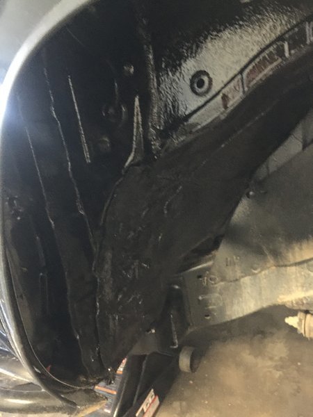

    You have me worried. Stock suspension, stock wheels with 1.25" spacer, big cab mount chop and a lot of time with a bfh. I think I still need to move my caster but I get 35s thrown on next week.
